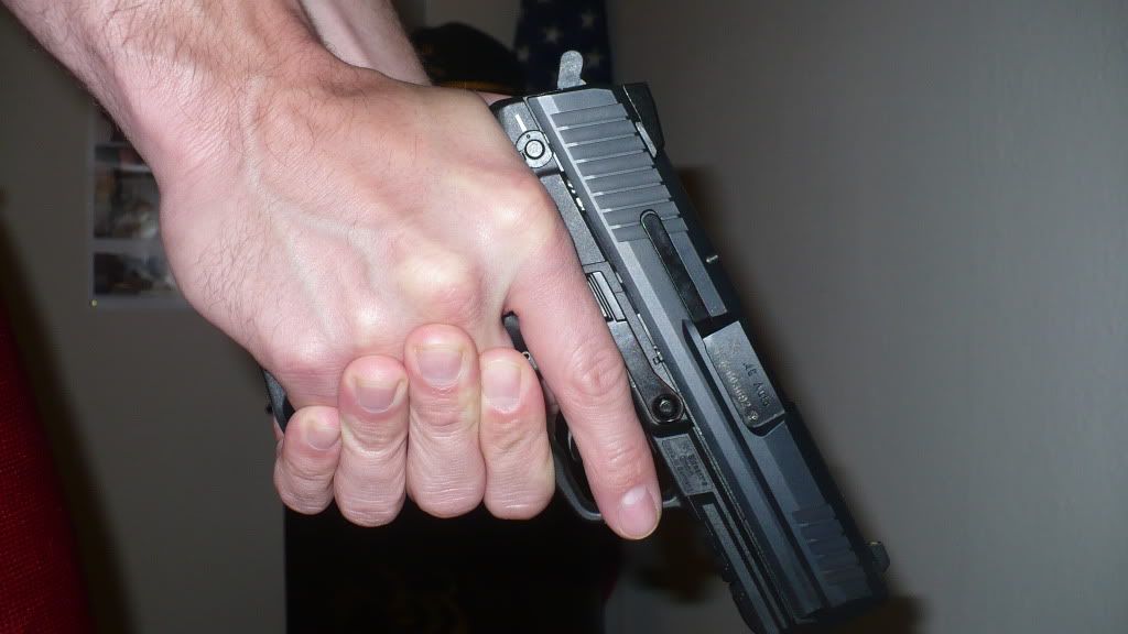

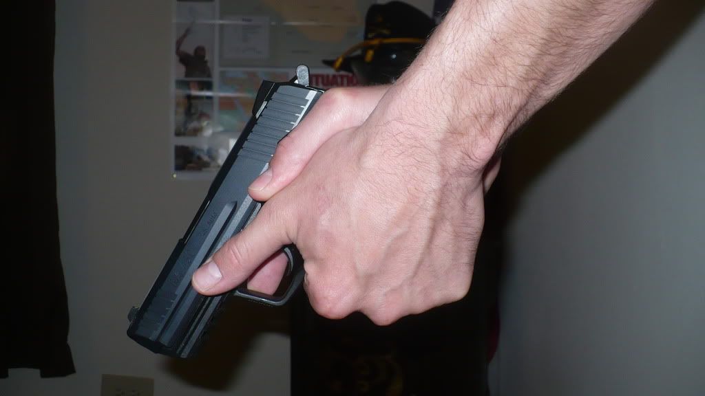

My second would be, My slide on my hk45C isn't locking back after the last round and it is not due to "Limp Wristing", what else could it be? It has only happened a few times and it happened to me yesterday while I was at the range. I have a very firm high grip on the weapon, and I haven't had any FTE/FTF which would also be a sign of limp wristing. I wish I had a video to post but I don't. I could possibly be hitting the slide release with my thumb. These are pictures of my grip.

Tuck your thumbs. You are likely preventing the slide catch from pivoting up after the last round exits the mag.

Got it, that is what I thought could be happeneing but I needed another pair of eyes to be positive. Feedback is always appreciated, one more answer to go any takers?
I agree, I lock my thumbs down, for me, it applies more power on the frame for better control/better aim, and keeps them from touching the slide and slowing it down, which causes malfunctions. YMMV.

You have a good grip there, I can see where your right hand may actuate the slide lock accidently here and there, but if you take some extra care in your right thumb's placement it will be fine.
I use the same grip shooting Brushing off the dust. (HK45 and G19 range day) - YouTube , That is an HK45 full size. But I may have a compact in my possession this week. Working on it. But I will see when I get it if it makes a difference.
But your grip looks fine to me, it is the one I use. I find the Magpul style grip gives you the most stability. But I do ride the rail with my support hand also, to keep from touching the slide. You can kinda see me doing that in the video.

I agree with these previous statements regarding your grip. That being said, you havn't stated what solvent you use to clean your firearm, but any solvent made specifically for guns should not hurt the rubber oring. Taking it off, like the others have stated, to me is a bad idea unless it needs to be replaced. Specifically because the more you stretch the oring taking it on and off the weaker you will make it. Its like any other piece of rubber, it may start to get a little dryer after being heated and cooled over and over, but once you stretch the rubber and possibly crack it, this can certainly decrease the life of the oring. I personally use Top Engine Cleaner to clean my firearms with all my orings on and they are still like brand new.

Luckily O-rings are the cheapest replacement part HK makes! Still take care of them though... Nice gun! I was hitting the slide release with my grip as well. My last range trip was a mess. Malfuctions due to dry/dirty mags and I kept hitting that damn slide release. It's like I forgot how to shoot my HK. Anyway, let us know if the slide locks back when you adjust your grip.

regarding the thumbs - that's the most common error I've seen with these guns (HK45, P2000, P30 all included there).

Agreed with what's said above, the solvent will not harm the O-ring. As for you failures to lock back, it is more than likely your grip influencing the slide release as already mentioned; however, this is the same grip that I use. Just make the necessary adjustments and move on. No need to tuck your thumbs and besides, tucking your thumb and/or thumbs up grips are so "70's."
