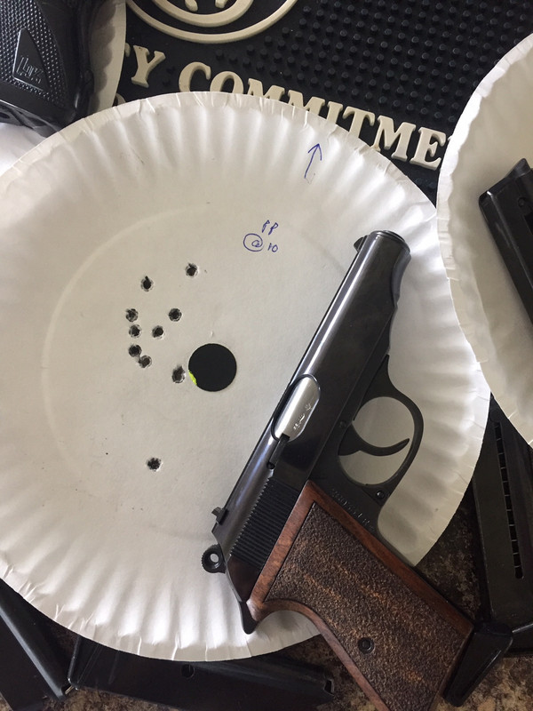

Next one is a rimfire Walther PP. I have had a few of them over the years and had one of the first rimfire PPs made in Zella Mehlis according to the curator of the Walther museum. I gave that one to my son who babies it. Well, this one has not been shot a lot and has a kind of harsh trigger. I blame the trigger for the one that got away, down left. I have spent a lot of trigger time with rimfire PPs, so it did well on the rapid fire drills.

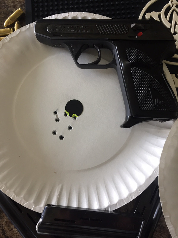

Finally, the rare HK4 in .22 l.r. that actually works and has the correct extractor. The gun has laughably small sights! Picking it up and aiming, it is not impressive but that first impression is deceptive and firing that gun will quickly change that first impression. It is really easy to shoot well and has a smooth trigger and very little felt recoil. It looks as if HK engineers got it right with their buffer technology! Rapid fire is a breeze and a ton of fun. The "4" in HK4 stands for four calibres that can be shot by just changing barrels and magazines and flipping the breach plate around to put the firing pin in the proper positioning. HK quickly found out that the shorter centerfire extractor was not working well and had a dedicated rimfire extractor marked .22 l.r.
This little HK is my favorite plinker and "warm up" gun that I use before running the same drills with centerfire guns.
