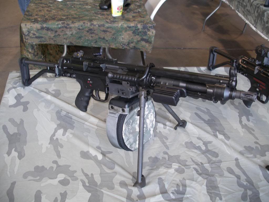

You could try:
Similar to what Ralph is using on the .308, just substituting the .223 backplate.
Pic of .308 below from RDTS website:
Best,
TC

dt662--- I run my MM53 pistol with the Choate looking buffer/cap shown above by Turbo Com...runs fine full auto but to be honest I usually run the MM53 as SBR with a fixed stock instead.
As an aside... Turbo Com's example of ace block + ace folding stock + recoil rod assembly is exactly what I run on my PTR-32 full auto....runs fine.
