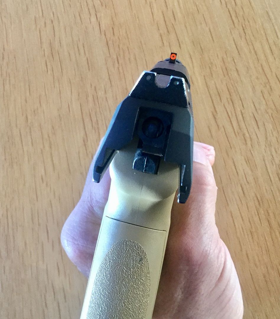

Based on a thread elsewhere, Trijicon realizes they have a problem with the rear sight and sharpness. Hopefully they will offer more rounded rear sights in the future. In the mean time, I took a file to mine. Won't win a craftsmanship award, but the edges are softer:
Hrm... You know, I probably could soften up the rear sight on the HD's a little bit. I've done some light file work on sights and other stuff in the past, and I have Black Magic cold blue....

I would try an Emery board first with rough side, all youre trying to do is break the sharp edges ... Files scare me on delicate work like this. :D
