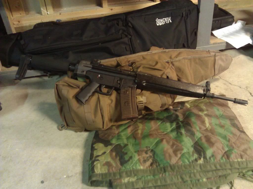

Well I purchased my C93 knowing it may have bolt gap problems. I shot 140rds and bolt gap went to .005 from .011 from when I purchased it. I sent it off to ghillie to get a barrel installed. Got it back and bolt gap was .018. Long story short after 60rds she is back down to .007. Spoke with ghille and trunion is junk so she is going back next week to ghillie to get a new trunion.
But before she goes back I thought I'd at least get my ACE stock fitted and installed how I want it. Here is a pic of how she sits before she goes back. Afterwards she will be getting a paint job but for now:
RCM 1in7 barrel
4 prong Mini
Roberts HK91 adaptor
ACE HK91 adaptor and Modular stock

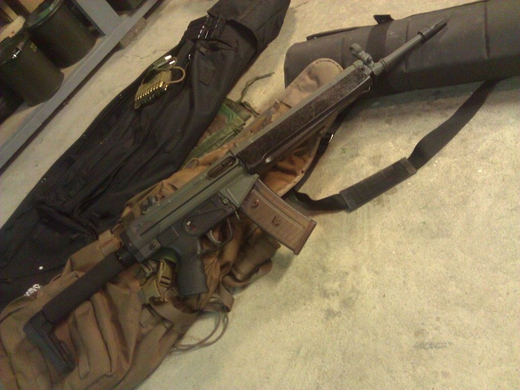

OK Update.... Got my rifle back from Ghille with the following work completed. Barrel installed, over sized barrel pin installed, and paddle mag release installed. Have since put 360rds down the tube and it eats everything I give it. It never had a failure before the work but it has yet to have a failure after as well. I've added some parts, ACE Stock, Clipped and pinned grip and a paint job. I couldn't be happier.
Here is how she shot on a dirty barrel at 75 yards with iron sights.
I know you purists are probably mad at me for going green on the receiver but every other weapon I have has a green finish. Thanks Ghillie for doing great work as always. No I need to start saving up for a PTR 91 and send it off to Ghillie for a rail and paddle mag install.

That's exactly what's on it ;).. I was shooting the 75gr Hornady Steel match with that group.
