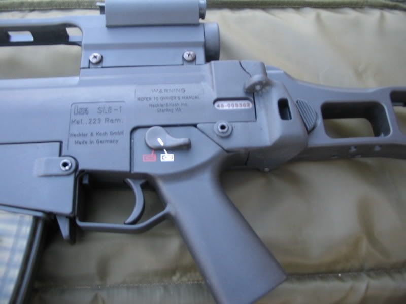

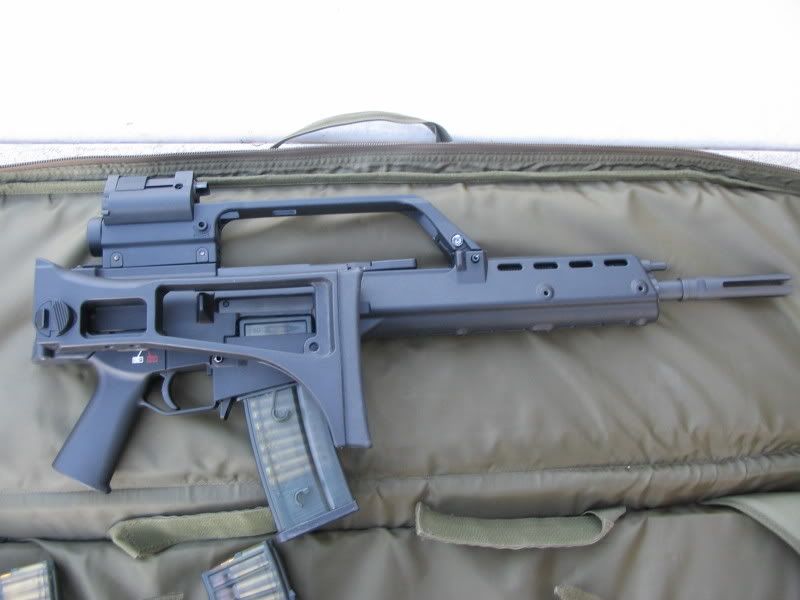

yeah i bought a couple lottery tickets today, so i'm kinda hoping that will do the trick but if not, at least i'm well schooled in the art of g36 conversions and could do it again if/when i get the means to do so. the coolest part is saying i did it, and being able to share it with everyone else. it was quite an adventure.

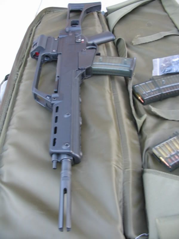

it's an sl-8 barrel. i wanted it to look authenctic so instead of having a vortex put on there i paid 150 for an urbach flashider, four in four prong, i chose the four in fh because that would bring my barrel length profile down to what the k variant would look like so the eyes would focus on th prong fh instead of the extra 2 inches of barrel that would be sticking out with a shorter flashider at 16 inches, making it look more like a carbine and less like a full length variant. hdps did the work i requested, cut barrel, threaded 1x15, crowned barrel and pinned and welded the FH. ed does an awesome job.

it's actually a tbostic gen 1.5, i worked clsoely with him on the details, the length of pull is much shorter than the top notch and hdps and closer to the real thing. that was made to order, well worth the wait. i'm trying to keep unattached from the rifle as i'm getting a lot of inquirings about it and it might go soon. but it was a goonies adventure and i'll never forget it.

tom bostic made the conversion block, he does a couple versions, i selected the gen 1.5 version after a lot of research, i had to cut the rear section of my receiver off and drill some holes for the total connection of the inner and outer block to the receiver. it takes a lot of precise work but it's worth it.
