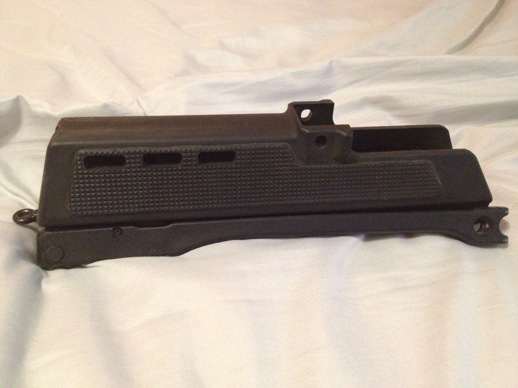

I found this K handguard from a local guy and traded until I got it. I'm pretty sure it's a rare piece, as I've never seen another one like it, but have no idea where it might be from. If anyone has any clue, I'd love to hear about it.
The rubberized checkering on the sides isn't too squishy, but it does give some really nice grip, and the three vent holes really sets it apart.
