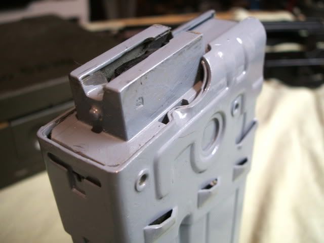

The steel mags are 20 rounders and are quite substantial owing to the extra guts of the 20 round .22 mag inside it . The paint on the mag is light gray. And while it is not exactly GunKote, it looks like it will have long service life.
