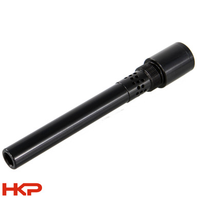

Barrel: B&T MP5SD Barrel / Dakota Tactical

View of B&T barrel:

#8 · (Edited)
Does this barrel work?
Not to build an SD. SD barrel is much shorter and is ported to slow (most) supersonic rounds to sub sonic. Lot's of good videos on the internet that explain how the gun works.
This is what you'd be looking for if you want to go the SD route:
There are also other manufacturers of SD barrels (RCM, etc).
Make sure to pay attention to thread pitch to ensure compatibility with the suppressor. I believe that 18x1 RH is what allows for the most compatibility for cans currently made for the US market.

Is the below in place of the official HK chamber brush such as this one? (https://hkpartspro.com/hk-mp5sp5mp5ksp5k-cartridge-chamber-cleaning-brush)
- 12 Gauge Bronze Brush with brass rod – to clean chamber
For the Silicone Plugs can you please reshare the Amazon link? Doesn't seem to work for me (unless its just me).
For the SchleTek suppressor cleaner did you use half of a 500ml bottle or the 1000ml? I didn't even know this existed and must order asap for my B&T SD suppressor....more stuff to order ha. Also, what would happen if I didn't blow out the suppresor with air afterwards and let it air dry overnight - is that a no no?
Overall outstanding once again 👏🏻 👌🏻

Ah, I wasn't aware of any other brushes needed outside of the chamber face brush and flute brush, you've taught me a lot! Another tool I "need", ha (I'm a bit cleaning obsessed as well). Glad to have helped with the link for flute brush, get one, well worth it.
No rush on the plug link, not something I need "now" just something i need to eventually order, along with the B&T solvent, as part of my SD "kit".

I only use the 12 GA brush because I already had it. More of an improvised solution that's additive but not necessary.
I think as long as you have a chamber face brush, the "flute" brush and some picks you'll be good to go.

(2) extra extractor springs H&K MP5/SP5/MP5K/SP5K 9mm Extractor Spring
(1) extra HK O-Ring. Sourced it from Dakota Tactical. Joe recommended using the HK O-Ring with the B&T suppressor and not the “oversized” orange O-Ring.
O ring orientation – the round (non-beveled side) should be oriented towards the muzzle (I’ve seen a lot of stuff on the internet with contradictory information). As you can see from my this write up, no issues with accuracy, baffle strikes or reliability.
Cleaning Gear (MP5 Specific):
Chamber Face Brush
-I sourced mine from Blue Ridge Supplies. https://hkpartspro.com/hk-mp5-chamber-face-brush Straightforward and easy to use. I was concerned with steel-on-steel contact with this tool (carryover from sniper training). No issues whatsoever.
Barrel Brush – Sourced from Dakota Tactical. In my opinion, an absolute must (see earlier in this thread). I opted for the handle as well. I was neurotic about steel bristles over the crown (see above). No issues with accuracy or crown damage.
Q: Why the blue tape?
A: Bottom Line Up Front – Let's me clean the barrel without having to remove the heat shield.
Not recommended to run the bristles over the barrel threads. The tape gives me a visual reference on how far to go down before the bristles contact the barrel threads. This is easy when the heat shield is off, but impossible when on without the tape.
