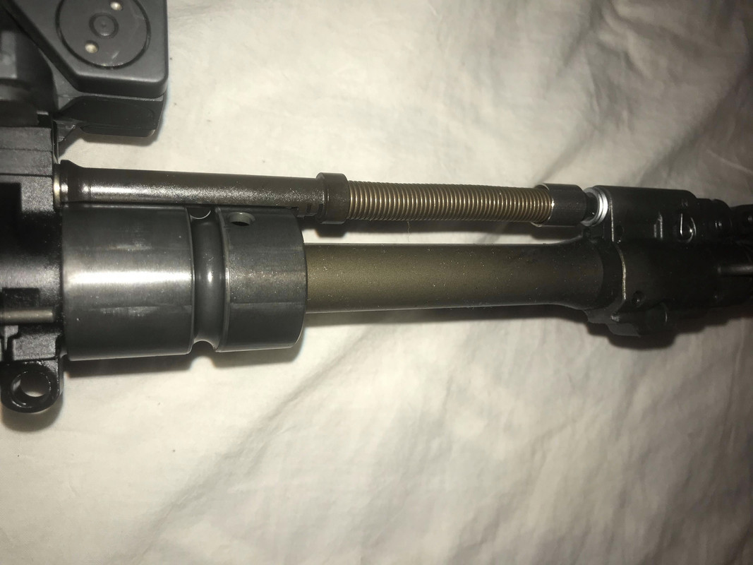

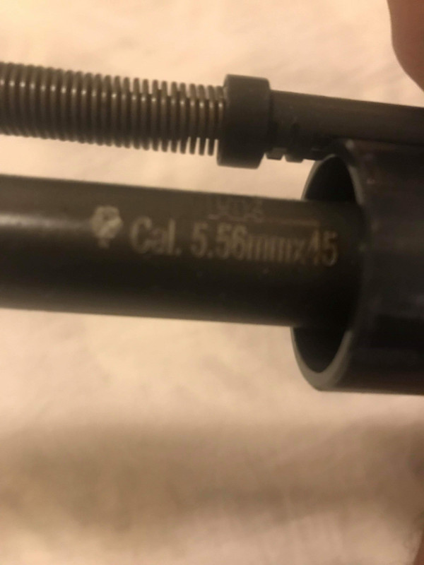

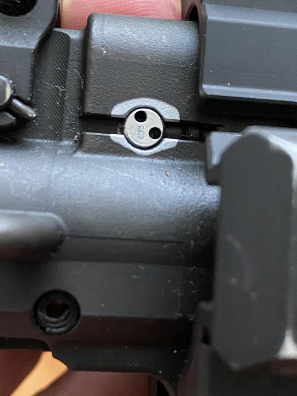

I’ll post more pictures later - but here’s an English production 416C with the same adjustable gas block that came on the rest of them. Most of them had sling loops and no bayonet lugs.

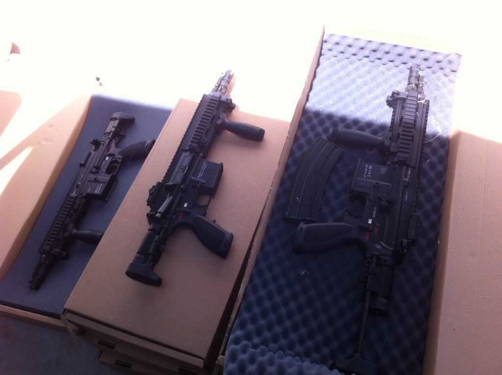

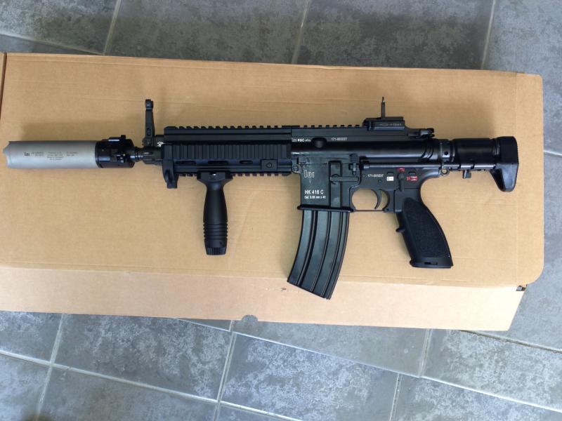

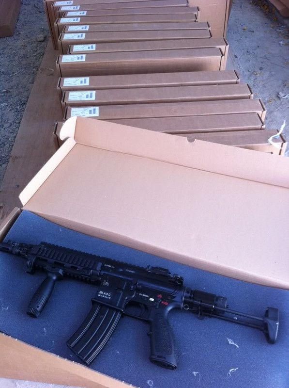

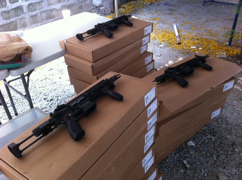

Here’s a few different ones from the Philippines PSG (Presidential Security Group - AKA - Secret Service). BC date coded with serial #s 171-000250 +, adjustable gas blocks, etc. Some factory 416C’s had the buffer retainer hole and roll pin hole, some did not.

Thanks for posting those 416C pics, wow, sexy.
Interesting, they use the same piston as the G36C/K. Makes sense. Very cool.

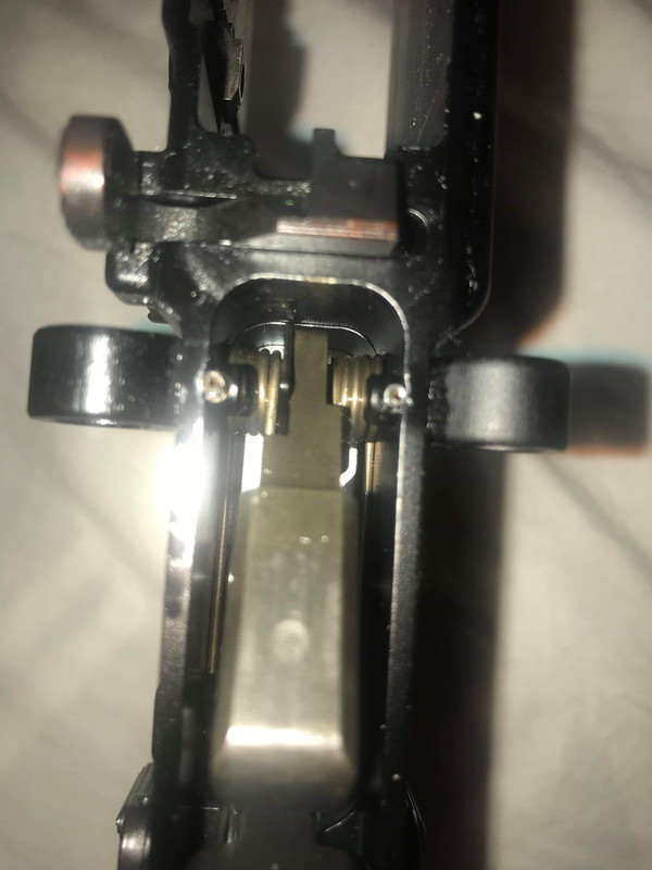

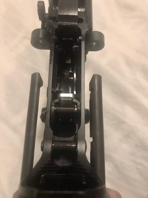

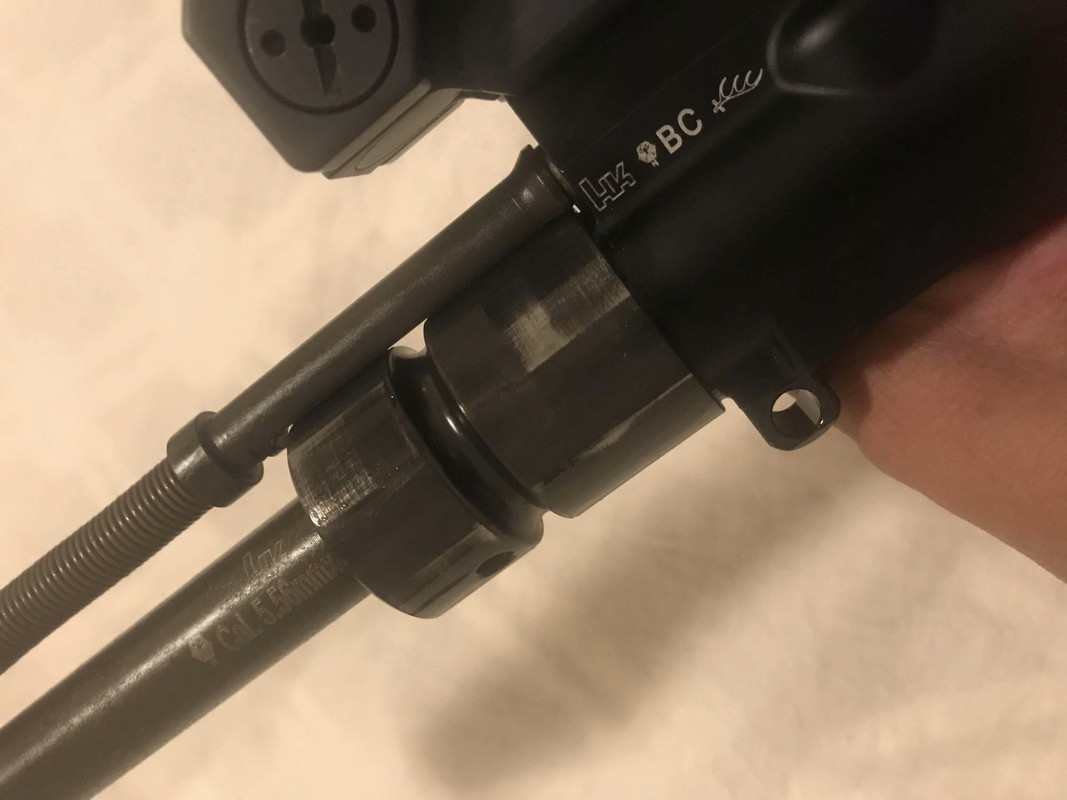

A couple more close ups of one of the Philippines PSG 416C’s. A lot of people have not seen how the C stock strut support eyelets are attached to the lower receiver. There are 2 vertically driven roll pins that secure the eyelets to the lower receiver, and a slight notch machined into the lower receiver that prevents the eyelet from rotating when the roll pin is installed. You can also see that this BC date coded HK416C still has the buffer retainer holes present even though it is not required, and some other models came out before and after with the buffer retainer holes eliminated.

Purty kewl!! I wondered how the supports were installed.
