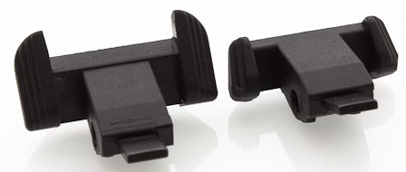

BTW, i have one on my USPc 9mm and one at the moment without. Comparing the two side by side i see just how big a difference the ext. mag release is..

Here are some comparison pics if it helps. This is a full size USP9.
