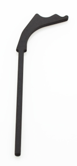

Are you or are you not using the new-design hammer strut?
You need the new hammer strut. If you're buying from HKParts, they have the wrong description on the old hammer strut. It is NOT the new-style strut.
ETA: Use the hammer strut that came with the other gun (USPt) and see if it solves your issue.
