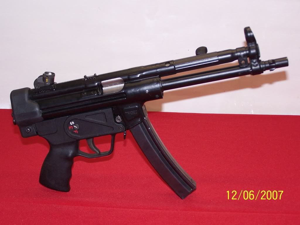

hey guys im in the process of buying a mp5 clone and the owner states this is the heaviest barrel he has ever seen .. did hk ever make a heavy barreled mp5 ?

It's probably an early stainless SW MP5 barrel.

The earlier thick SW barrels work fine. Their just a little heavier and the lugs may had to be fitted for the factory flash hider. I wouldn't worry about it.

Were the lugs on early SW barrels not correct or withing tolerances? I have a 2000 SW5FS that I'm wanting to SBR. I just bought a HK 3 lug flash hider, I hope it fits when I get my Form 1 back and remove the fake suppressor.
269 Posts
yes, there were many reports of out-of-spec-ed fittings. hopefully, during the
build, this would have been tested and corrected. but it never hurts to ask.

1,278 Posts
Don't worry about the lugs if they're slightly off. You can fix it with a small fine file. I noticed the edges of the lugs were a little too square and it can be fixed with a few little passes on the corners.
There will be a total of six areas (two sides per lug) that can be done within 3-5 minutes. If your barrel needs to be fixed, remember to use equal passes on each corner, which is very little material is removed.
The barrel can be refinished with the barrel tip being masked off and Gunkoted. You can heat the tip up with a hair dryer or heat gun for a few minutes and you're finished.
PS: The lugs are fine for mounting flash hider, sound suppressors. The diameter is fine and that's what the lugs go off of. As long as you don't get happy with the file, you'll be fine.
These are just the little things that inspire people to work on their own guns. I bought a junk Century Arms .308 rifle which caused nothing but headaches. I ended learning the whole build process from working on that gun.
