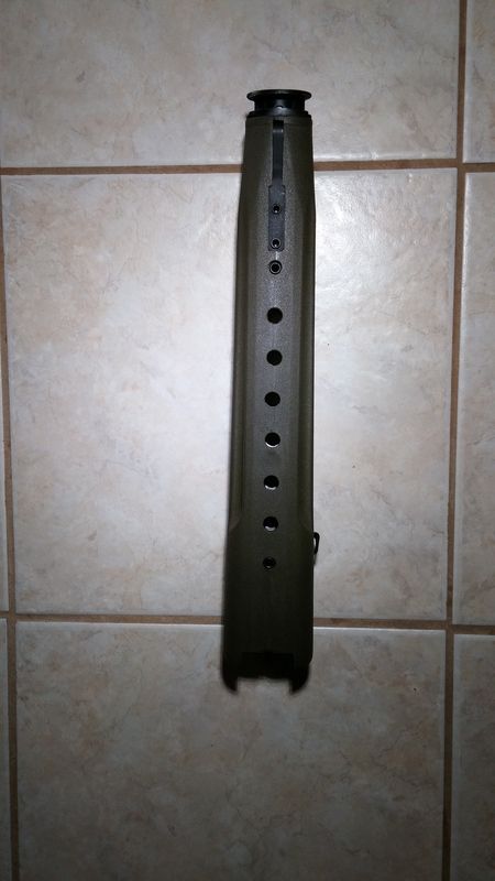

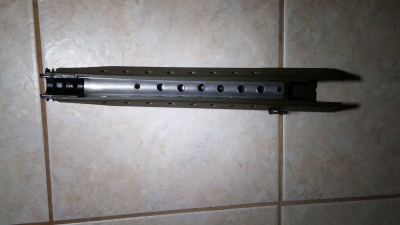

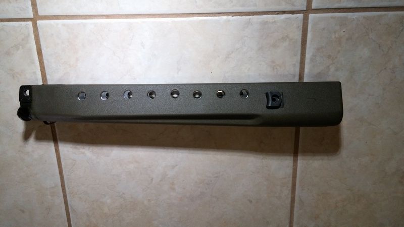

I basically copied the Nambian style forearm except I used holes instead of slots. Unlike the original slimline green plastic forearm that came on my PTR91 GI that gets HOT!! (even with the heat shield) after a bit of rapid fire (40rds), the wide forearm didn't get hot per se but you could still feel a bit of warmth. So I figured why not and drilled some holes. I used a block of wood to support the heatshield as I drilled.
Now I can feel the heat escaping from the forearm and it barely warms up when shooting. The wood forearm I first went with didn't have the heat issue as bad as the slim plastic one did but still warms up more then the wide one does. I still have a set of wood furniture I can swap to if I want, as I really like the look and feel.

Well honestly I was hoping for you to add a side view before I commented, but doesn't look too bad from what I can see.
How'd you do it, drill press, mill, free hand? What diameter holes did you go with?

Sorry the picture was there it just didn't show because I had missed a formatting command.
I used a drill press after I laid out the locations with a ruler. The bottom was easy as I could simply hold it against the table but due to the angle of the sides I had to do those semi-free hand as I braced the forearm with a piece of wood while working the press. I started with an 1/8" pilot hole and then used a 3/8" for the final size. A block of wood inside kept the heat shield distortion to a minimum but I admit I could have done a better job of that part.

Thanks for the details, I'd be tempted to do similar, but don't have ready access to the equipment I'd like to use, and I'm leery of botching a green wide forearm. I have messed around with the slim forearms, drilling out the holes, and cutting them down to 93 length, I usually take out the heatshield and rivet it back in when I'm finished.
