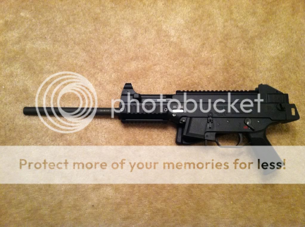

Well I finally did it...I have been sitting on the parts for almost a month. I just didn't have the time to commit to doing it properly until today. All in all, I spent about 4 hours on it, although it easily could have been done much quicker. I decided to take my time on the finishing and just enjoy the project. Everything I read on here about the difficulty of those pesky springs in the lower was extremely accurate LOL. I used a dremel on the mag cutout and had no problem, I just took it very slow--probably only 1/100 of an inch taken off each pass. I function checked it and everything works :) I am gonna try my best to get it to the range tomorrow.
If you have been thinking about doing this one--GET ON IT!!! I'm far from a mechanical genius and it wasn't that hard

I figured I might as well show a few "in progress" pics too:
lower parts
stock block fitting
mag well enlarging
the before shot...with my other .45 (Kimber)

Your UMP conversion looks awesome! It is on my "to do" list! Out of curiosity, how much of the barrel is exposed? I would want to add a faux suppressor, but I'm guessing it would be at least 9" long?
88 Posts
Discussion Starter #10
its about 8.5-9" exposed
