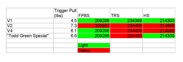

I believe that I would not have to change the trigger spring in order to make the V-TGS mod as I believe a P30 V2 already comes with the trigger spring that one would use in a V-TGS modification. I think it is a 234389. In any event even if I have the part number wrong I think I am right in that the trigger spring that is already in my P30 is correct for the V-TGS. I think that I would have to change the FPBS to the lighter version, 209296 spring. Lastly, and here is where it has been most confusing for me (unless I am already wrong about the trigger and FPBS) is the main/hammer spring. Since my P30 is already an LEM, V2 I think what has been posted leads me to believe that I do not have to change that spring in order to get to the V-TGS. I believe the correct main/hammer spring to order would be the 214300. However again if I am reading posts correctly I think the 214300 is the spring that is shipped in a P30 V2 LEM from HK, hence my comment about thinking I will not have to change the main/hammer spring as part of my V-TGS modification. So first, have I got these spring parts properly identified in order to make the V-TGS modification to a new, P30 V2, LEM pistol?

As far as I know, P30 with V2 LEM comes with hammer spring 214695, not 214300. To convert to V-TGS, you'll need 2 springs: the Light FBPS, part 209296, and the hammer spring, part 214300 (which is the same DA/SA V3 hammer spring in the P30L).
Btw, the TRS in V2 is 234405, not 234389.

The above chart may help. Note that the Hammer Spring in V1 is incorrect. It should be 214695, not 214300.
