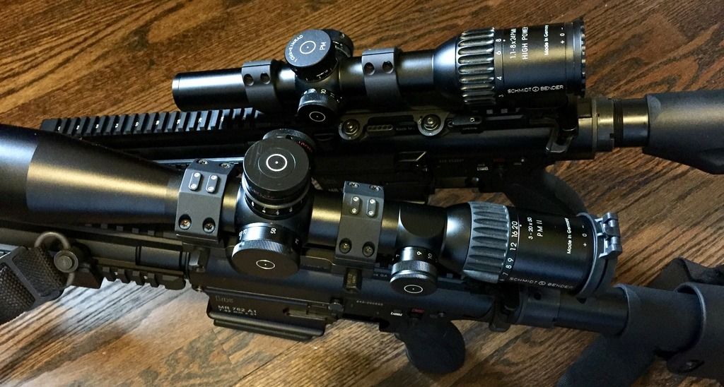

The "High Power" 1-8...NEAT! I like the cut of your jib @fatmat. You should bring it on a fieldtrip downstate and let those beauties stretch their legs...
3,669 Posts
Thanks dms16, I'm still going to change the LaRue mount to a similar Era-Tac so it still has to be mounted/leveled.
As @dms16 said, looks great. I'd love to know how the High Power 1-8 compares to the PMII Short Dot 1-8.
PS -I went with a Geissele mount for short dot 1-8. Couldn't decide on which ERATAC so I let Geissele decide for me.
