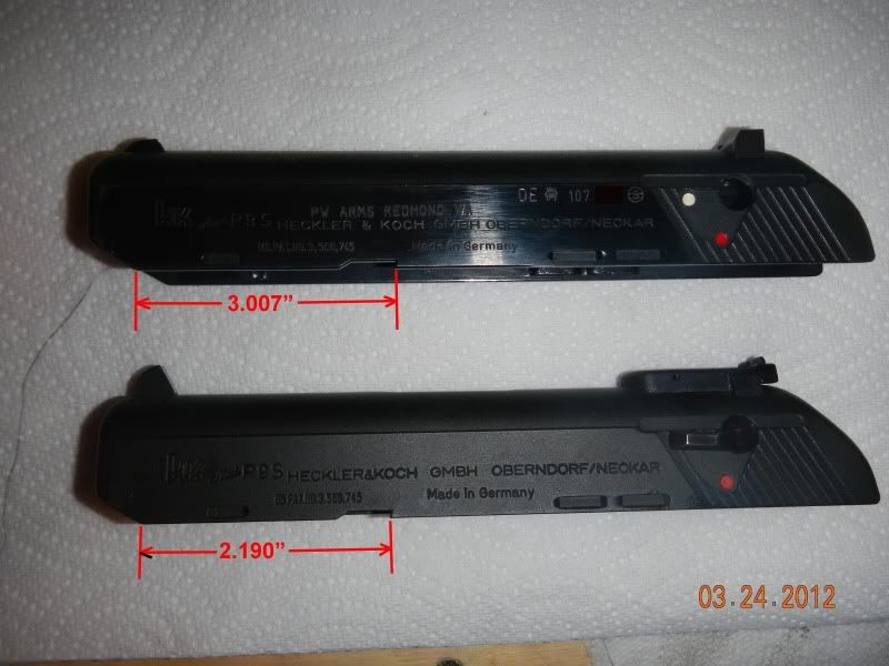

The other noticeable difference was that the slide would not go rearward far enough to engage the slide stop. It stopped approximately 1/8" before engaging the stop. Measurement shows the slide stop notch in the slide is actually cut in a different location on the new slide. Measurements from the same spot on the front of the slide are marked below.

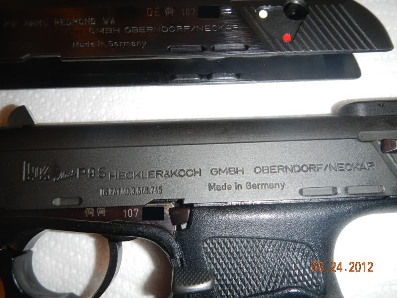

Here's what it looks like when I pull the slide fully to the rear. You can see how it needs to travel a little farther before the catch can engage.
I shot it for the first time today with the new slide. The sights were hitting at POA at 20 yds. using 147 gr. ammo. I was not surprised when the slide would not return fully to battery when firing. I would have to push it the last 1/8" or so to fully close. After 3 or 4 mags I stripped it, re-oiled and reassembled. After that it seemed to run fine. I don't think it failed to return fully to battery after that. I only ran a little over 100 rounds through it, but this was encouraging.
The other thing I discovered was that the slide actually would move far enough rearward to engage the slide stop. Of course, it was now in so tight I could not disengage the stop. I had to use a small flat screwdriver and a mallet to gently tap the catch out of the notch. After doing that a couple of times, I would shoot until the mag was empty but there was still a round in the chamber. At this point, I would leave the gun hot, engage the safety and lower the hammer. Then I would reload mags and repeat.
I'm thinking I'll use a small file and adjust the notch until it matches the location on the original slide.
Does anyone know when / why HK would have changed the location of the notch? Was the mag catch modified on later frames? Or possibly the buffer was slightly shorter, allowing a little more slide travel. It appears I'll be able to get this working fine. I'm mostly just curious.
