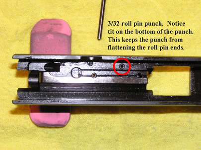

Do you push the pin from the inside of the slide out through the top?
Yes, to prevent accidental marring of the slide. Use a 3/32 roll-pin punch. The extractor roll-pin is the one circled in Red in below pic.
