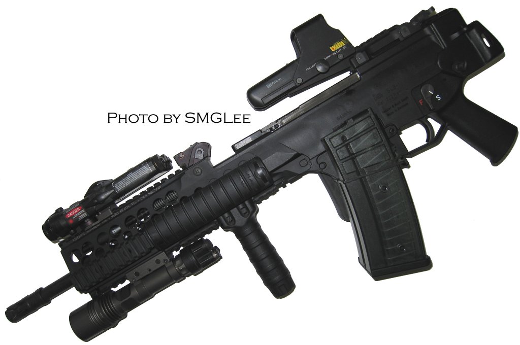

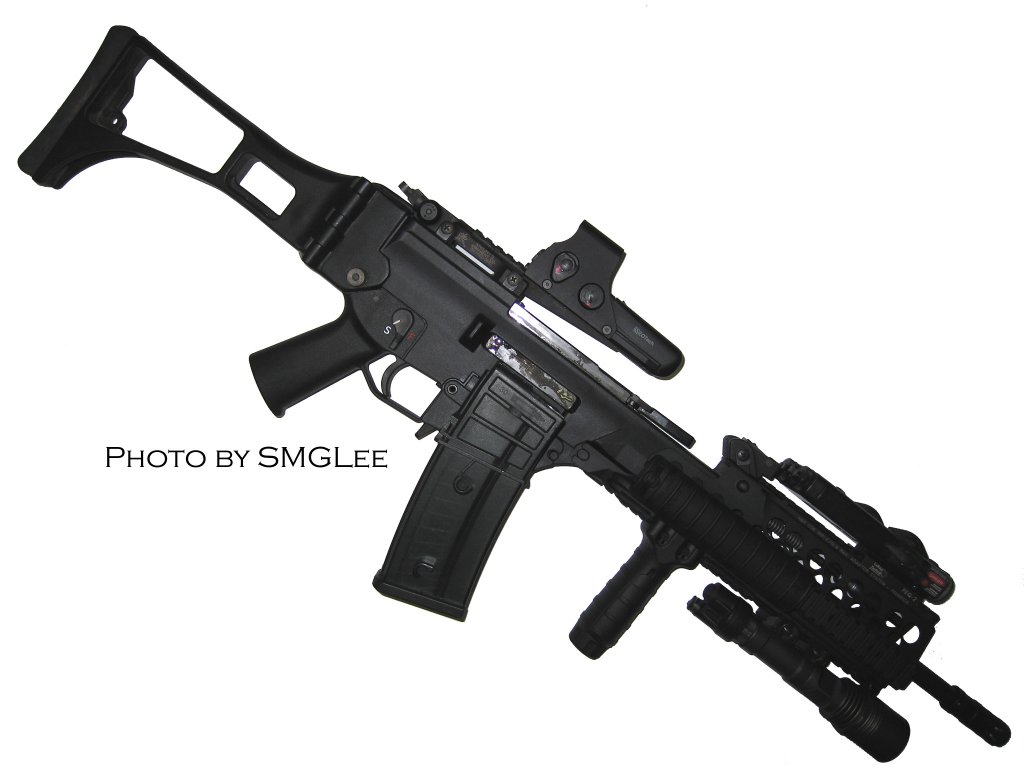

Finally with SL36CQB using the TBostic Gen2 conversion block
Compare to the factory G36CQG

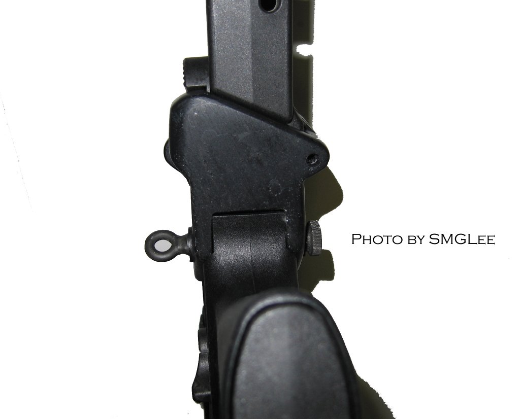

A few items of interest. I had a tier 1 defense industry machinist do the work on this conversion. He measured and measured to make sure everything will fit nice and tight. The only problem we ran into is the factory HK sling swivel pin which is a tad bit too short. The TBostic Gen 2 block is thicker to cover the receiver and it has an reinforced ear surrounding the hole for more strength. My machinist took about 1/100th off on both side on the reinforce ear and also a bit off the collar on the sling swivel pin to make the whole thing come together. The pin is super tight inside the receiver with the conversion block, I guess he could have made it a bit looser, but he figure it will loosen up in time.
This job actually took him about 2 hours to do since he was quit careful and did everything to as close of a tolerance as possible. I think this could be completed within an hour on a DIY. The biggest time consumption process was machining the reinforced ears and pin collar and also the actual cut of the receiver. He had to find spacers to secure the receiver in his mill and that took some time to get everything line up perfectly and the cut is uniformed on both side to 1000th of an inch.
The over all set up…
HK SL8---1500.00
Dye----DIY, cost of four bottle of Rite Dye from K-mart and some gas bill from boiling the water
G36CQB barrel conversion by LarryG36---150.00
G3 flash hider
KAC flip up front sight
KAC long rail with flip up 600m rear sight
KAC G36 rifle RAS
Surefire M961XM
TangoDown vertical grip
Cav Arms Rail ladder---Left over stock
G36C stock from Center Mass----100.00
G36 SEF trigger housing from HKPro member---100.00
EOTech 552
T-Bostic Gen 2 block----320.00
SW M16 mag conversion, SW stock conversion x 2 are some of the left over parts from previous conversion. I think I recover some of it by selling them on line but I probably lost close to 450.00
Total invested-----$2620.00 minus the cost of the KAC, Surefire and EOTech gear.

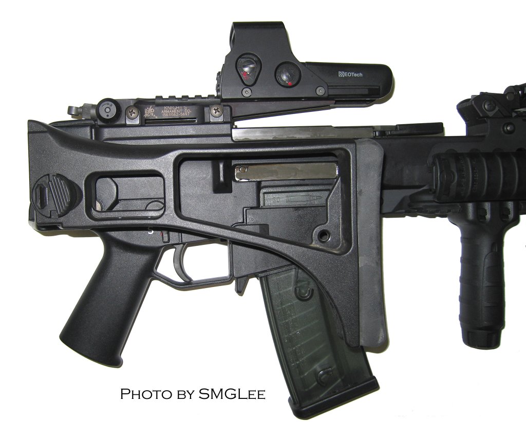

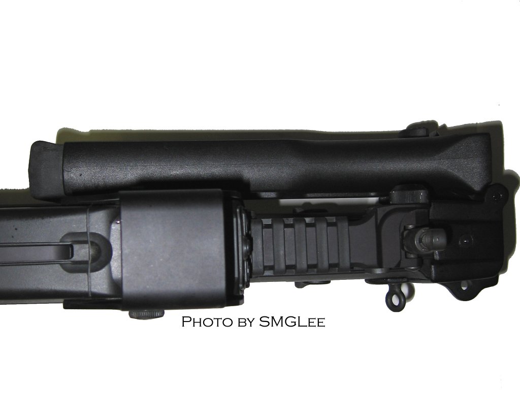

Stock folded view

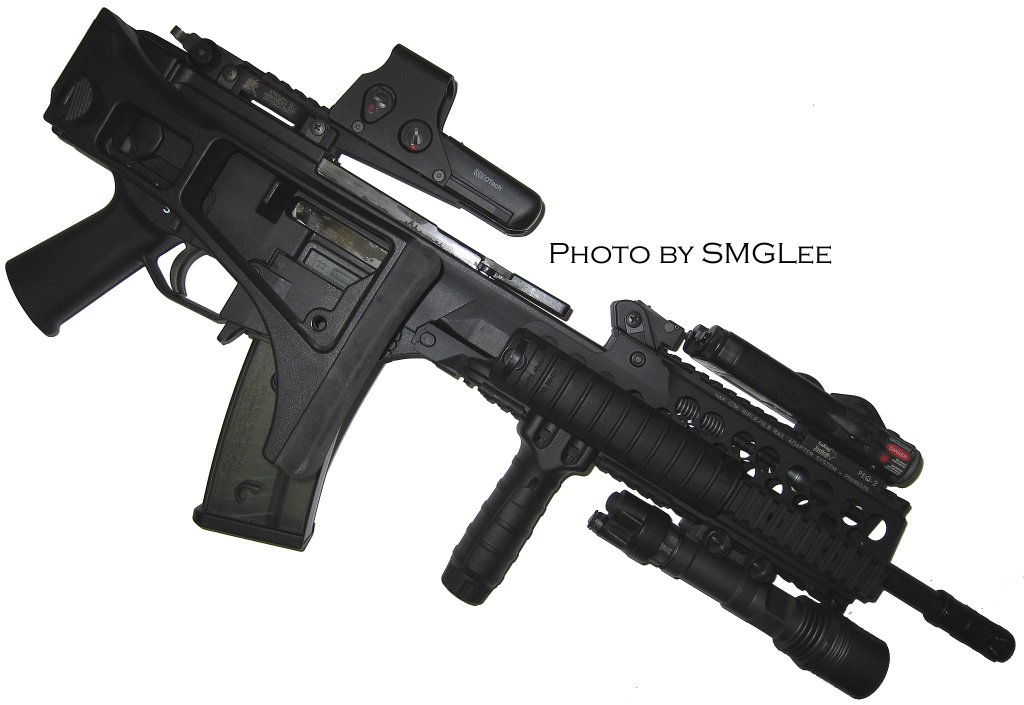

Stock folded view from ejection port side, I will find out if the brass can be ejected with the stock closed, not that I would shoot the gun this way, but inquiry mind wants to know.
A closer view of the stock closed. Note the KAC 600m rear sight, with the TBostic block surrounding the receiver, the sight is elevated a bit. It actually made activating the rear sight that much faster.

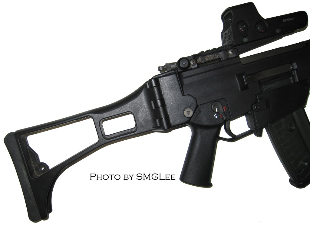

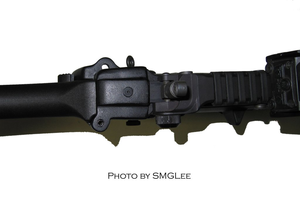

A better view of the Gen2 block with the stock open.
A top view of the block. A small allen screw is all that is holding the block on the top.
Bottom view of the block vs. the trigger housing interface.
Stock folded, you can see the large allen screw that is securing the block to the trigger housing block that is lock into the trigger housing via the take down pin.
top view of the stock folded

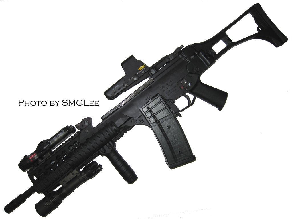

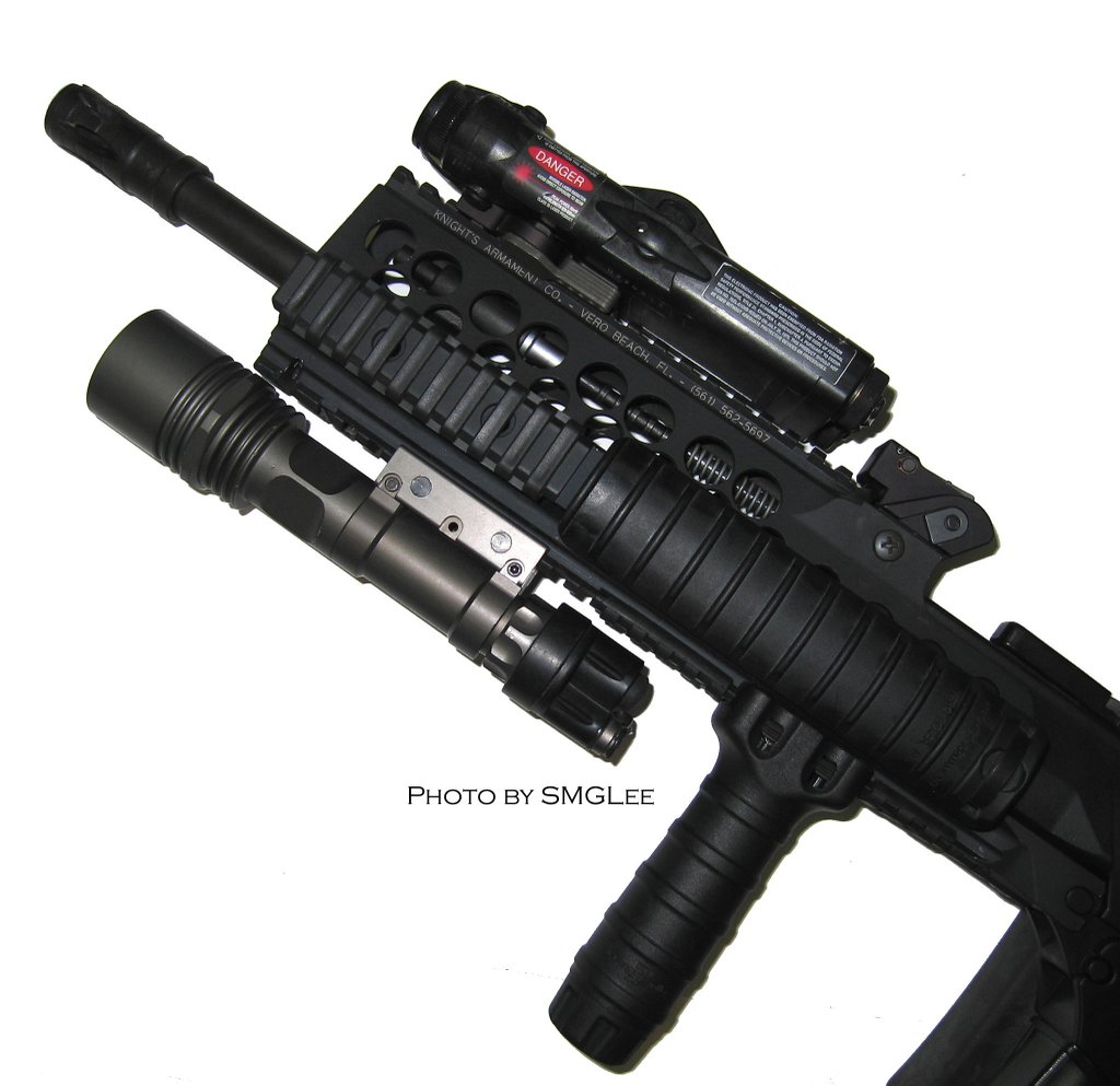

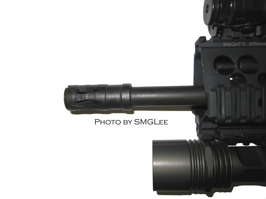

Business end of the gun I call----SL36
G36CQB profile barrel with G3 flash hider.
