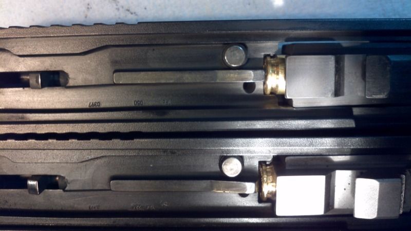

I started thinking about your comments regarding those who have reported failures with conversion barrels. For the most part, the complaints I have read from others had to do specifically with those who were running silencers on their guns. Many reported that the barrels required a couple hundred rounds unsuppressed to break in before they were reliable with a can. In these instances, they reported that the barrels ran just fine without the suppressor attached.
I still stand behind the principle that its not a great idea imo to fire a smaller casehead in a slide designed for a larger one--
Your comments piqued my curiousity, so I thought I'd go see just what discernible difference I could find. As it turns out, it appears the extractor has full purchase on the extractor groove in the case. One detail that may be overlooked is that the extractoris pushed inward by spring pressure. The extractor on the .40 slide appears to be able to move inward far enough to still fully engage the groove on the 9mm case head.
Hopefully, this picture shows the extractors well enough to see what I mean. The top slide is a 9mm slide with a factory 9mm barrel, and in the lower one has the LW conversion barrel in a .40 slide. I was going to try to take the picture with the barrels fully locked in the slide, but you couldn't see the extractors well enough. I've got the barrels pulled slightly forward in the picture.

You have a barrel that supports the case - often more fully than the factory barrel. As shown above, the extractor fully engages the case (although that's a reliability issue, not a safety issue). Please explain why these are any more "dangerous" than a factory barrel.
