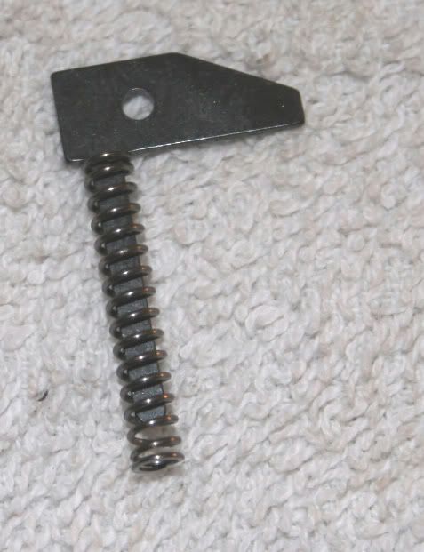

Then using the punch through the control lever hole, push up on the slide plate and remove it and the spring. Save the slide plate and spring because you will put it back in later.

Now, install the slide plate and spring, depress with the 1/16 punch and with the control lever at 12:00, slip it in.

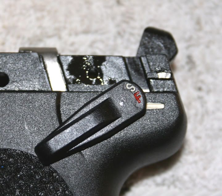

Now you have your LEM AND a safety. Of course the decocker will not work but you do have a safety that so many people want.

The decock function will no longer work even if you do the swap to a V1 as I did. On a V1, after the LEM conversion the lever will still move down to the decock position but it does not decock so there is no reason as I see to not go ahead and use the V1 detent plate.
Now, if you do not like the lever moving down into the decock position even though it does not decock, you can put in the V9 detent plate and I think that will keep the lever from moving into the decock position but that is a personal call.

Normally LEM conversions do not have any type of control lever. The only safety is the FPB, the long take up, and the safety between the ears. I chose to retain the safety for reasons I listed. With the V1 detent plate which I retained, the lever will depress into the decock position but it does NOT decock. The only difference between the V9 and the V1 detent plate when used in the LEM is that the V9 detent will not depress, but remember, neither will decock in the LEM conversion. Both work as Safe Only.
