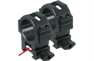

I did have to trim a little on the back of the ring to allow the rear castle sight to not rub for mounting. The scope is too low to use Iron Sights with the scope on. The rings are a quick release style and really solid. I use UTG rings on my Savage 110 Tactical 308 bolt gun. I also had to shim the scope in the rear ring to give more vertical adjustment in the scope and it also keeps the magnifier ring from rubbing.
For the rail mount, I am using the "GSG MP5 mount" because it is already cut to mount in front of the rear sight.
