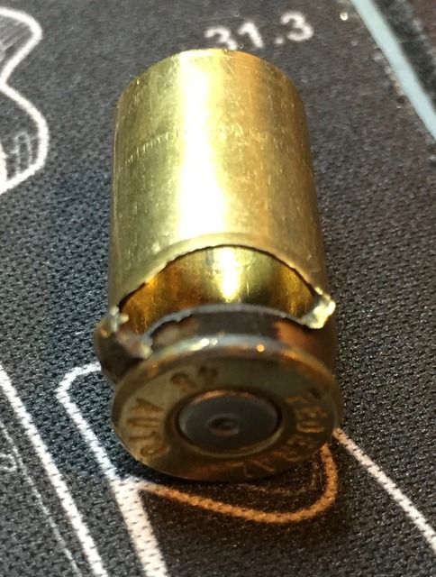

My reload, my fault. Double charge or separation of a .45 Auto case reloaded one too many times? I can't say until I investigate more. I would have thought the latter is more likely, but the flow around the primer indent suggests overpressure. The load was *supposed* to be 5.0 gr of Bullseye under a 230 gr. JRN, and I would have expected a double charge to have filled the case (and thus have been noted as I was placing the bullet on the case for seating).

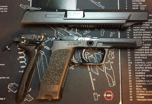

As far as the damage, it appears the magazine and grip took the brunt of it, saving my hands. I knew instantly what had happened from the odd noise and the hard "slap" both palms took. No injury; the frame performed perfectly as far as protecting the shooter.

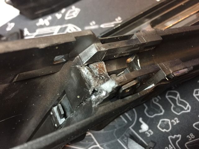

The frame separated at the rear of the magazine well:
and cracked at the front of the well, with some melting at the top, directly under the rear of the chamber:
Remarkably, it appears that every part in the frame except the polymer is undamaged, e.g., the trigger bar is not bent, the safety levers are still straight, the trigger/TRS and slide stop are ok, and the entire fire control group behind the mag well appears untouched and still functions smoothly. Of course, this is all before seeing what a detailed inspection reveals.

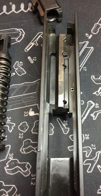

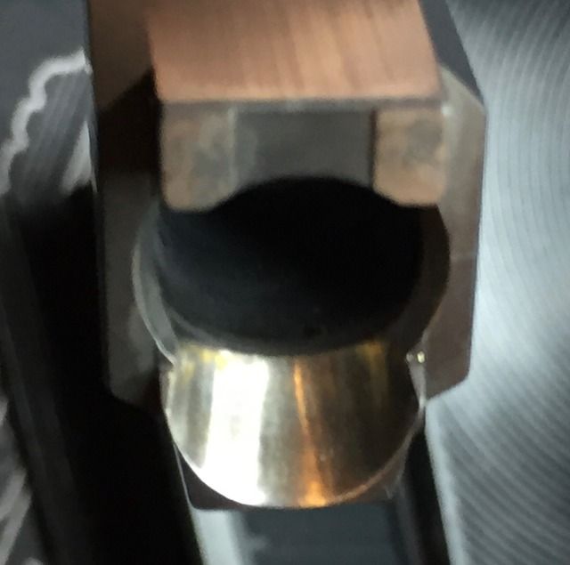

The slide, breach face and ejector appear to be unharmed:
Same for the recoil assembly. As to the barrel, I believe there *might* be a tiny amount of outward flaring at the upper left edge of the feed ramp -- HK will have to decide whether I'm seeing things and whether the barrel is serviceable:

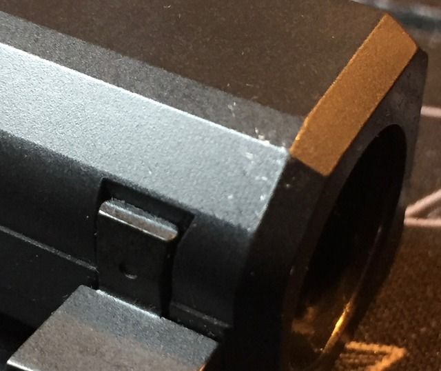

The cosmetic issues are scratches at the front left corner of the slide:

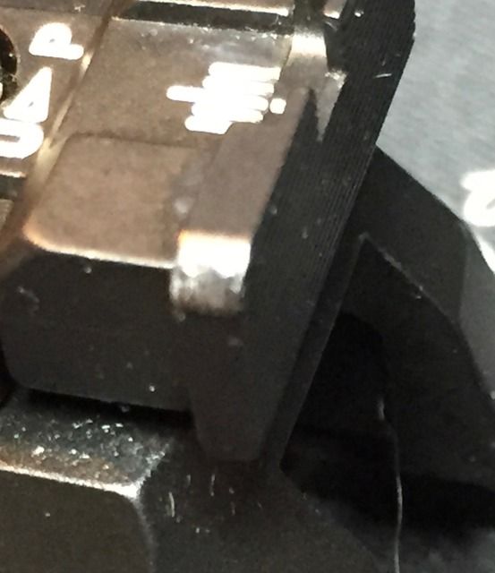

and an impact point at the left corner of the rear sight blade from the drop, which also drifted the sight to the right:

Since my post, I went back and did an experiment. This wasn't a brass separation issue.
My powder measure is currently set to drop 5.4 gr. of Bullseye. I expected a double charge to completely fill, and possibly overflow, the case. I ran a case twice through the press. I was wrong -- 10.8 gr. was 1/4" or so below the rim, low enough to be missed and a bullet seated to form a compressed charge.
I also inspected the case under a magnifying glass and bright light. I'll post pictures later, but in short there is zero evidence of a thinned section from too many uses, and every sign of over-pressure in the way the case deformed prior to rupture (I was an engineer in a previous life, and have more than a passing acquaintance with materials and dynamic material behavior).
Everything at this stage is pointing to a double charge -- one thing I thought I was being careful to avoid. The round that blew was one of my earlier .45 reloads, not long after I picked up reloading after several years off. I suspect I didn't have my workflow/rhythm in place yet. That said, I'm still going back and checking *every* load I have.
