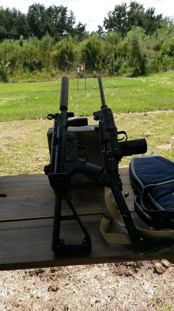

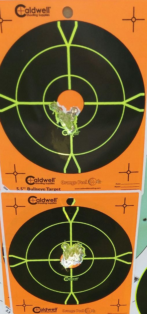

I put ~1000 rounds through my Z5-P as a pistol while waiting on my stamp. I noticed that with the stock locking piece, 147gr ammo and octane 45 the bolt was hitting the buffer enough to chew it up a bit. My stamp came in last week and I put on the B&T short stock, USA front grip and a #28 locking piece. I put 500 rounds through it Saturday and I am very happy. Smooth, accurate, no buffer wear at all. It cycles 115 and 147 with and without the stock and octane on it. I shot these at 50 feet with iron sights. Only limitation is my aging eyes. Each target has 30 rounds through it.

Could you tell any difference in perceived recoil?
Hard to say 9mm has much recoil to begin with. But yes, when the bolt hits the buffer it is harsh. Now it is very smooth. It didn't do it with 115gr and no silencer but 147 and silencer it would smack the back and the stock would have only made that worse.
