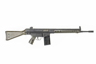

Just picked up my CA-3 today
Initial Impressions are rifle is built well, Fit and finish is also really good for the parts that were refinished. Welds all look good and clean. Bolt and carrier falls freely in the receiver, stock and pins are all tight with no wobble at the rear. Bolt gap measured at .019 Will update after a range day. Major parts are 1969 FMP marked and the bolt head is HK marked and 1966 marked.

Made a few improvements and replaced the damaged rear sight.
Ready to hit the range and see how it does. My other .308 Century/PTR rifles like Federal 168gr GMM. The Cetme C308 shoots about 2 MOA (iron sights) and my PTR91 DMR has done 1.3 MOA at 100.
I'll be happy if this is in the 2.5 MOA range at 100 with iron sights. The G3 sights are OK, but not the best for precision for me at this point.
I was looking for something to put my decent German green furniture on, and this fit the bill - which was right about $800 delivered.
I know it's just a mixmaster of parts - but I like!

Had my CA-3 out for the first time this weekend.
Not great results.
I shot some Saltech and Igman M80 equivalent, and also some 168gr GMM. None of it was better than maybe 4 MOA - even the GMM. Some of it can be attributed to me and my struggles with open sights, so chances are it's better than that. I actually had the wrong shooting glasses on, which didn't help.
One issue did come up, and I need to talk to PTR about it (Century doesn't do any warranty work on the CA-3).
The rear sight is all the way over to the right, and it's still consistently shooting left. The elevation is also off, and I was using the "4" (400) setting on the rear sight to get the POI to be on the POA at 100 yards.
How is the elevation adjusted on the HK-style rear sight?
It did function fine all day with no issues.

I have a pair of these I've been toying with. I can only echo what has already been said in the not so great column. My primary gripe is with sight alignment, both rifles shooting extreme left. One will zero right at the edge of the rear sight's limit, the other won't zero any closer than around 2moa left before running out of adjustment. I think I'll make that one a scoped rifle, now that I think I finally have an answer to the nearly three feet low elevation problem I've been chasing.
I can understand (somewhat) PTR's possible reluctance in building a super cheap gun that would compete with its better built and more expensive brand labeled models. But it really seems like they went out of their way to try to make these just bad enough to convince people to pony up a bit more and buy a PTR. The missing scope mount pad/lug, missing cuts on the bulges, and lack of finishing gives that attitude away. But not being able to zero the irons is either complete BS quality control, or a **** move. And PTR has been welding these things together straight with little to no issue for years. That kind of narrows it down.
I'll let you know if they fixed that issue with mine.
The sheet that they sent back with it said "bore sighting" or something, but not "realignment of front sight tower" or anything like that.
