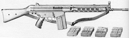

One last little thing if the original model g3 has a wood handgaurd why is it metal in these pictures? http://www.hkpro.com/image/g3old.jpg http://upload.wikimedia.org/wikipedia/en/f/fc/West_German_Mechanized_Infantry.jpg the g3 is the guy on the right in the second picture.
The wood handguard was declared standard in January 1959. There are different prototypes, one of them is a metal with bipod as shown. When evaluating a weapon there are troop trials. The weapon that is being tested is issued to troops for evaluation. If there are things that the troops don't like then they are removed or replaced. I believe in this case the sheet metal handguards were not liked and they were replaced with wood. These have a tendency to get hot under rapid fire.

Like that the steel handguard G3 is really early HK-made CETME prototypes/T&E models for the german government, IIRC called CETME DM3 or similar meaning CETME Deutsche Modell 3 or german model 3 in english.
