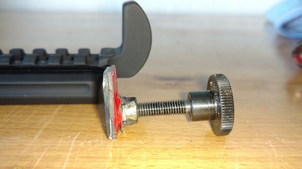

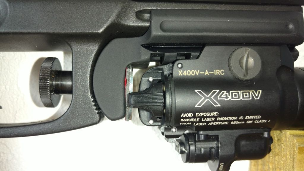

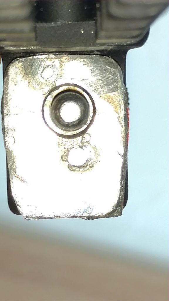

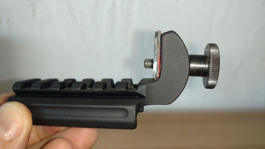

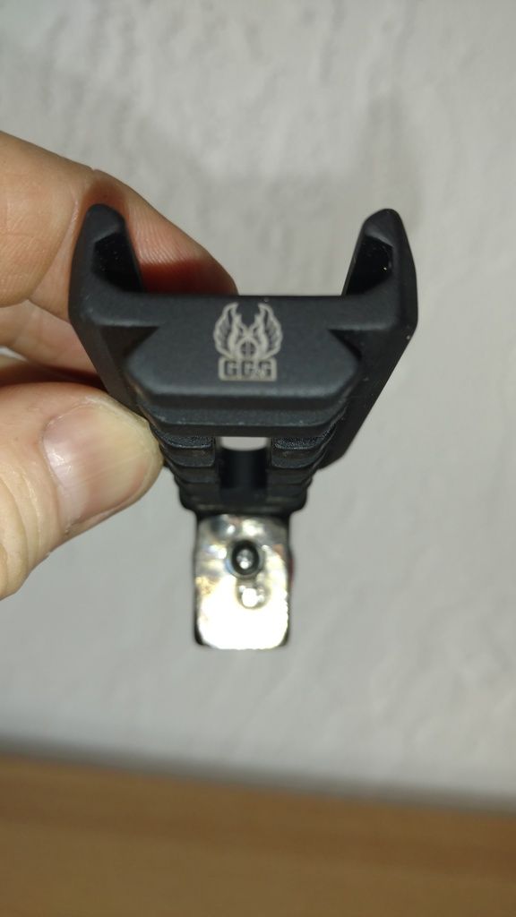

THE MARK 23 G,G&G ADAPTER - adapter!
As some of you may well know from my 3-D Printed Mark 23 adapter......I'm kinda long-winded. That being said, got a wild hair up my A** after the new metal adapter came out to be able to do what I always WANTED to do in the first place, make it Removable !!!
Without further adieu, and before I waste any more of my time (or yours) here is what I came up with in the garage. I made 5 of them. Stainless plates, TIG welded double nuts to fill the cap-head bolt cavity, and double-sided 3M tape. Now you can literally have it "both ways". Use the supplied 1/2x28 caphead bolt provided with the adapter OR try this Drop-In kit (with supplied ThumbWheel that passes thru the threaded insert in the t.g.) if you mount a Laser that you want to be able to 'dismount' but still have confidence in keeping zeroed.
The photos are "in the white" as I thought the concept would be clearer, but flat black spray paint has been applied and they're drying now in the Florida sun. To be frank, they are hand-made and quite inelegant, but perfectly functional.
If you're interested, P.M. me. Thanks for looking.
