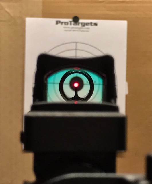

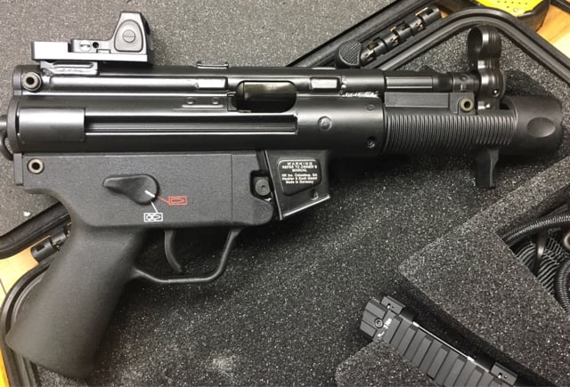

RMR direct mount to rear sight. This option replaces the rear sight with a mount designed for the RMR. Yup, this can't be called co-witness since there is no rear sight. How about: this is "absolute co-witness" height.
Pics from Oicani.
