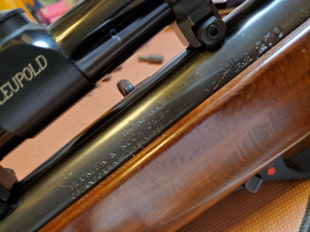

About a month ago I purchased this used HK 270 out of an estate sale--it came without a magazine so the estate accepted my counter-offer after I had quickly searched for HK magazines online. The rifle came with the excellent condition Leupold 2-7X rimfire scope and tbh I pretty much bought the rifle to get the scope.

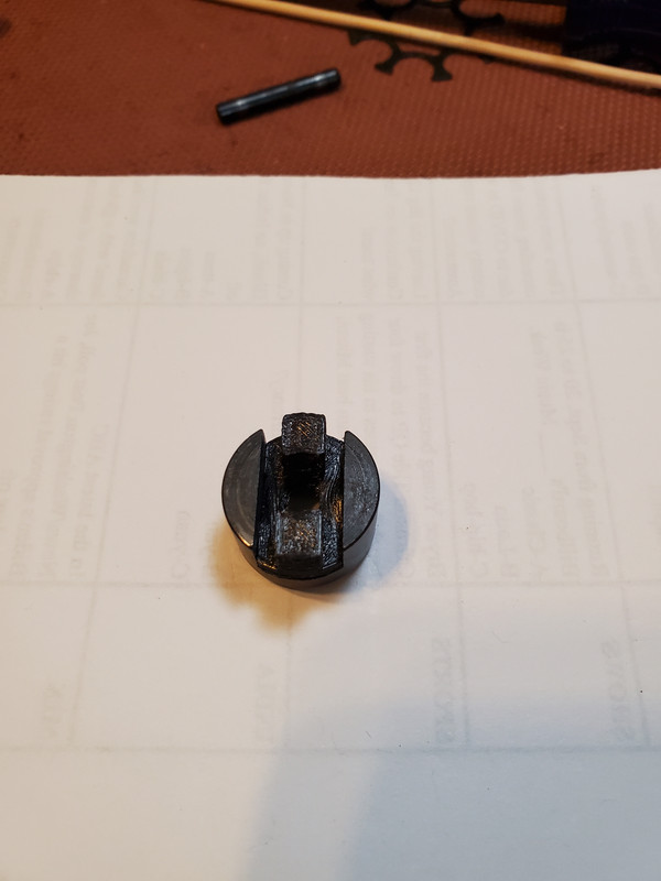

The price was great but at that time I was very unfamiliar with these rifles and yep, you guessed it--I found out after getting it home that the original buffer was all crumbled. An online search revealed no domestic source of buffers, so I took a chance and ordered a buffer online from Vaughn in Australia (Southern Cross Components). It arrived today (about 3 weeks in transit) and it is of very high quality, very well moulded and it fit tightly into the cap.
I had read that you might have to trim the buffer to get the bolt to lock back properly but I've had no problems with that--everything went together smoothly and the rifle seems to function properly.
BTW, the bluing on this rifle is just beautiful! I've owned HK firearms and I pretty much expected a utilitarian-grade finish but their sporting rifles feature deep, well polished BLUE bluing, much like the old-fashioned rust blues, not the hot-salt black. The stock is scratched and dinged but that just means it's not a safe queen--I will shoot it!

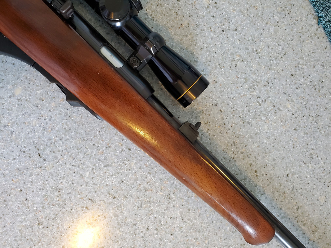

Well, here's what happened today--fired about 40 rounds, mostly standard velocity stuff then this happened:
In nearly 50 years of pulling a trigger something like this has never happened before.
Accuracy from this rifle was OK, but no better than my 10/22s and of course after the rear sight fell off I had a little more difficulty concentrating on shooting groups.
All told I fired about 100 rounds with 2 failures to feed the second round--there is some fore and aft play of the magazine in the well and I think the long magazine may have bumped something on the bench. I think it was seated properly, since the first round fed and fired properly. Right now fiddling with the magazine is the least of my concerns.
I think I'll just clean off the barrel and oil it up, I'm using the scope and not the irons so it's not that big a deal as far as shooting it--as for Teutonic quality, well the pictures tell the tale, don't they?

WOW. That is crazy. What a shame… looks like maybe it was spot welded or rather epoxied on and cleaning solvent over the years corroded it and caused it to fail. Not actually sure how they were attached originally . I’ve only ever seen a couple of the HK 270s with the rifle sights like the 300. All the others have the diopter type. , just a guess, Hard to say…😖never seen or heard of such .

Well, i took the rifle apart and sprayed some kroil on the spot, waited a few then hit it with the Big 45 stainless steel wool ball--turns out what looked like epoxy was actually silver solder (or silver braze). When the light returns tomorrow I'll take a picture of it--it's all nice and shiny now, lol.
You can see that there wasn't quite 100% "coverage," if that's the term, of the silver solder to the surface of the sight base so I guess over the years gun oil must have crept in and compromised the joint. Either that or the bluing salts must have gotten in the gap and corroded the joint. The bummer part is, of course as we all know, if I were to send this rifle back to H&K they would just confiscate it and I'd be out a scarce collectible (although not in it's present condition). For now, I'm just going to leave it alone and shoot the rifle some more.

The replacement buffer showed no sign of wear, in fact the only thing I noticed was that a crumb of the original buffer got flattened by the bolt against the new buffer--no problem there, I just scraped it off. I think Vaugh's buffers are A-OK!

Well it really sucks that that happened. A good gunsmith could reattach it fairly easy. Probably wouldn’t even need to re-blue. Yes they are an intricate little bugger when you take them apart you have to pay attention to the orientation of the internal parts.
Vaughan will be glad to hear the news about the buffer. I am waiting on a couple of three pin HK 300 buffers to arrive to test for him. The material he uses for the buffers is spot on. I spent a couple of hours cleaning all of the crumbled up little bits of degraded buffer out of an HK 300 a couple weeks ago. The old brown jelly looking material had dried out ,cracked and completely crumbled. Disassembled and Blew out with a can of compressed air. It was a real mess.(see pic)

Yeah silver solder ,especially older silver solder jobs are susceptible to corrosion like that… that’s the first time I’ve ever seen a sight base detach from one of the HK sporting rifles. Looks like it was a weak solder job and years of corrosion finally got to it.😖

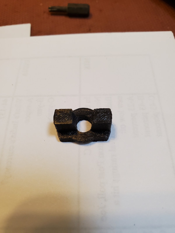

It's a longshot, but do you have any way of measuring the hardness of the buffer?
I made a single-shot mold and found that the same material for ear-plugs works great. I bought a durometer, as well as the sample pack from McMaster-Carr, but I have no reference to compare to.
Maybe this:
Maybe this:
I would say that earplug material is way too soft. The buffers I have tested for VAUGHAN who is making them is much more robust rubber than what an earplug would be. This is his email maybe contact him and talk to him he’s a great guy.

* I caution again I would not use any material as soft as what an earplug is made out of for a buffer in this rifle.*
