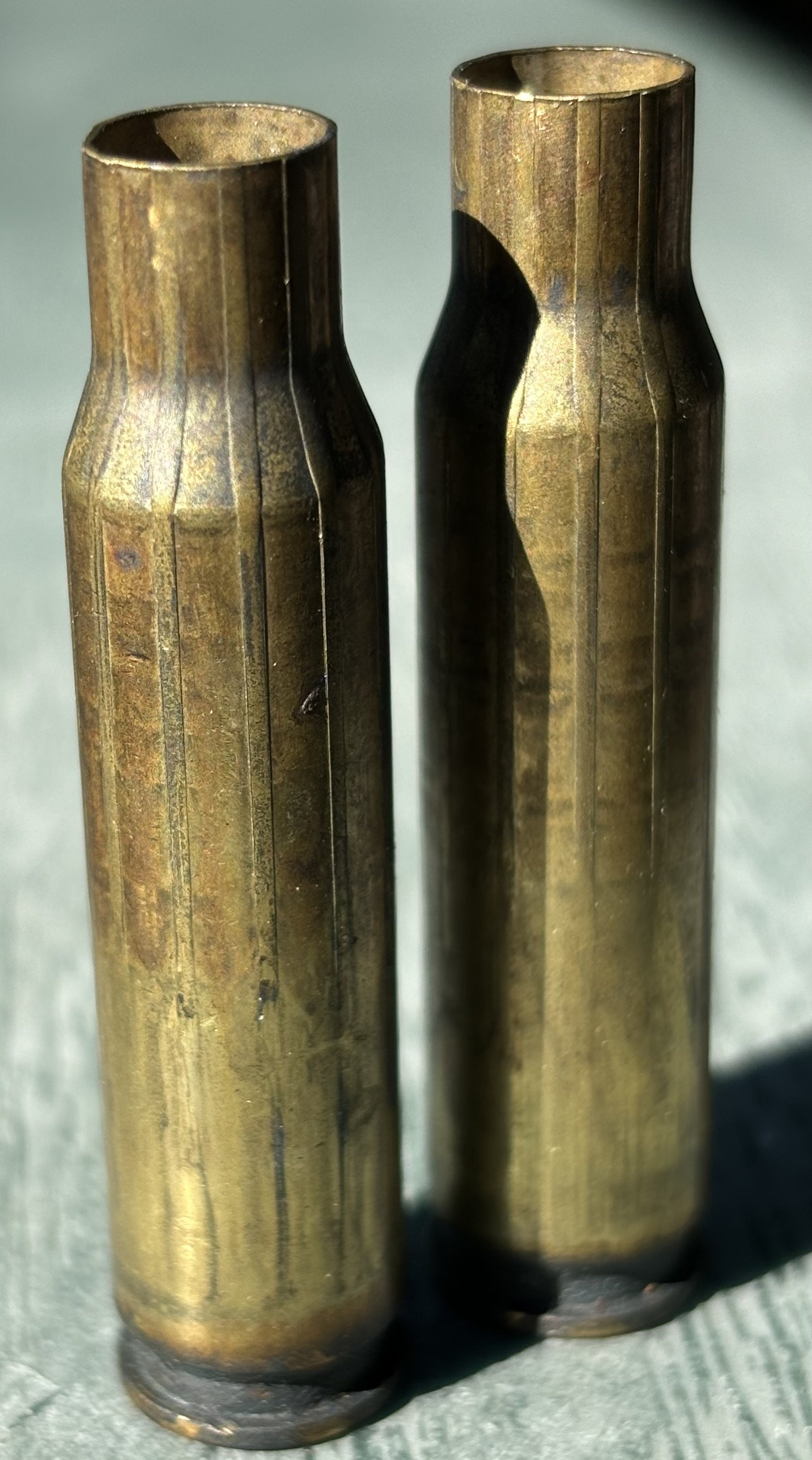

Never an issue with my g3k or hk 51 ptr clones. Both needed about 2 mags to break in and then awesome. I use lower angle locking pieces to reduce recoil and flow through suppressor but that’s the only change from stock configuration.
If you want to help eliminate issues use 7.62x51 not .308. This is true for HK or PTR. See comparison below.
What are these cases?
Specs show .308 and 7.62 x 51 case length to be almost identical - or at least not enough difference to be significant.
I did ask the OP what ammo he was using, but haven't got an answer.
