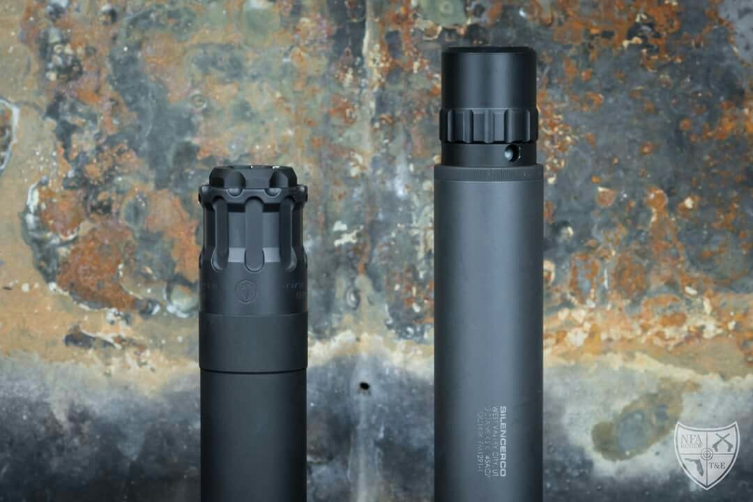

Indeed! Thanks for the post. Yeah I have a prototype version, it's done they are just waiting on custom springs for it. They should be releasing it asap! Most of you know I provide photos Rugged and other companies out there so I'll share these here to give you a better look at the 3-lug.
I will say this is the most solid 3 lug mount I've ever used. I don't know if this is a internal vs external thing but there is ZERO wobble. I've had issues with Gemtech and Silencerco (both external) 3-lug wobbling on my 9mm Glock mag SBR's barrel. The Obsidian mount is SOLID. If I had to guess, this has to do with the way the piston inside is machined. It seems the internal type 3-lugs have more surface area surrounding the 3-lug barrel once inside.
I like the 9mm endcap. The Obsidian didn't exhibit any increased port pop and shooting the full length setup on a G17 wet with the 9mm endcap was a religious experience lol. I shoot cans every other day and I was taken aback. That being said.... don't forget to swap the endcap back when moving to a 45 host! DOH!

Although I have an Octane 3 lug coupler for my Omega 9K, I like the Rugged Obsidian's 3 lug coupler much better. Threads in no issues, locks up just fine and cuts another inch or so off overall length vs the Omega 9K + Octane coupler.
Setup seemed hearing safe to me (although I ran it with foam plugs in, like always). No issues so far with several mags, 147gr. Recommended, if you can find one.
Here are some pics:
Just became my new favorite can and mount combo!
