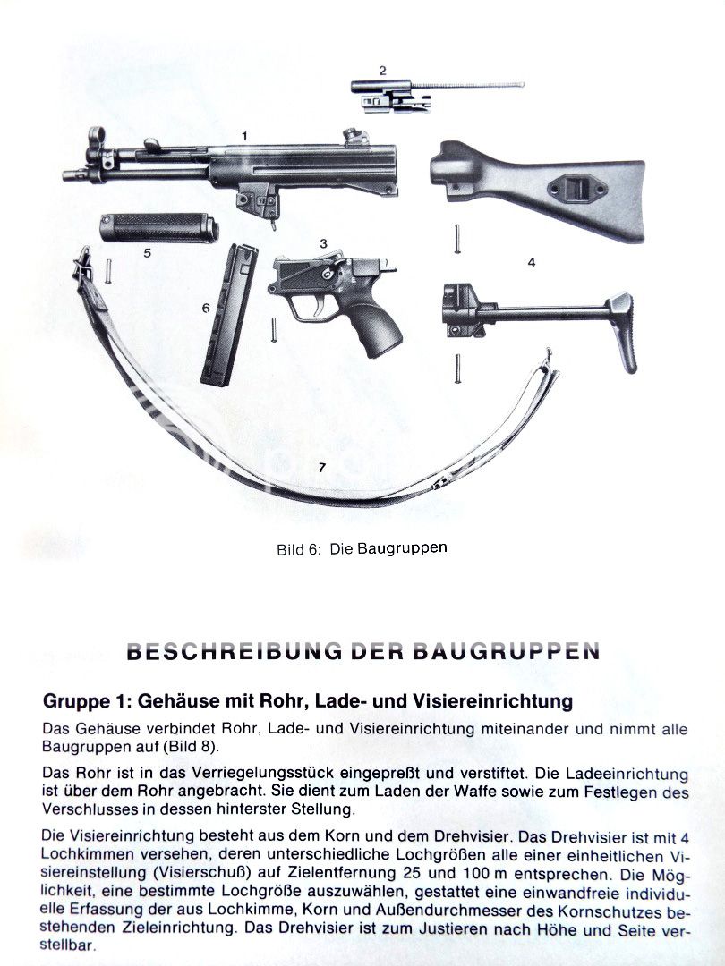

#29 ·
The sling mounting point on the A3 collapsible stock is fixed to the back plate. The rear clasp that are on the slings will fit both the A2 and A3 stocks.
Sling configuration will work on both stocks.
Obviously not a picture of a G3 but it shows the option of using both stocks on an MP5 with the 3 point sling.
(7.) bereitschafts trageriemen (preparedness carrying strap)
