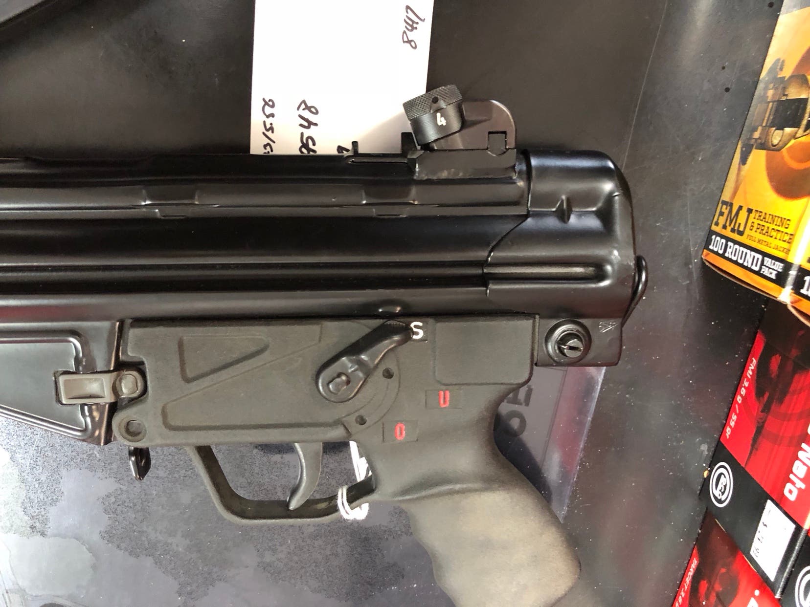

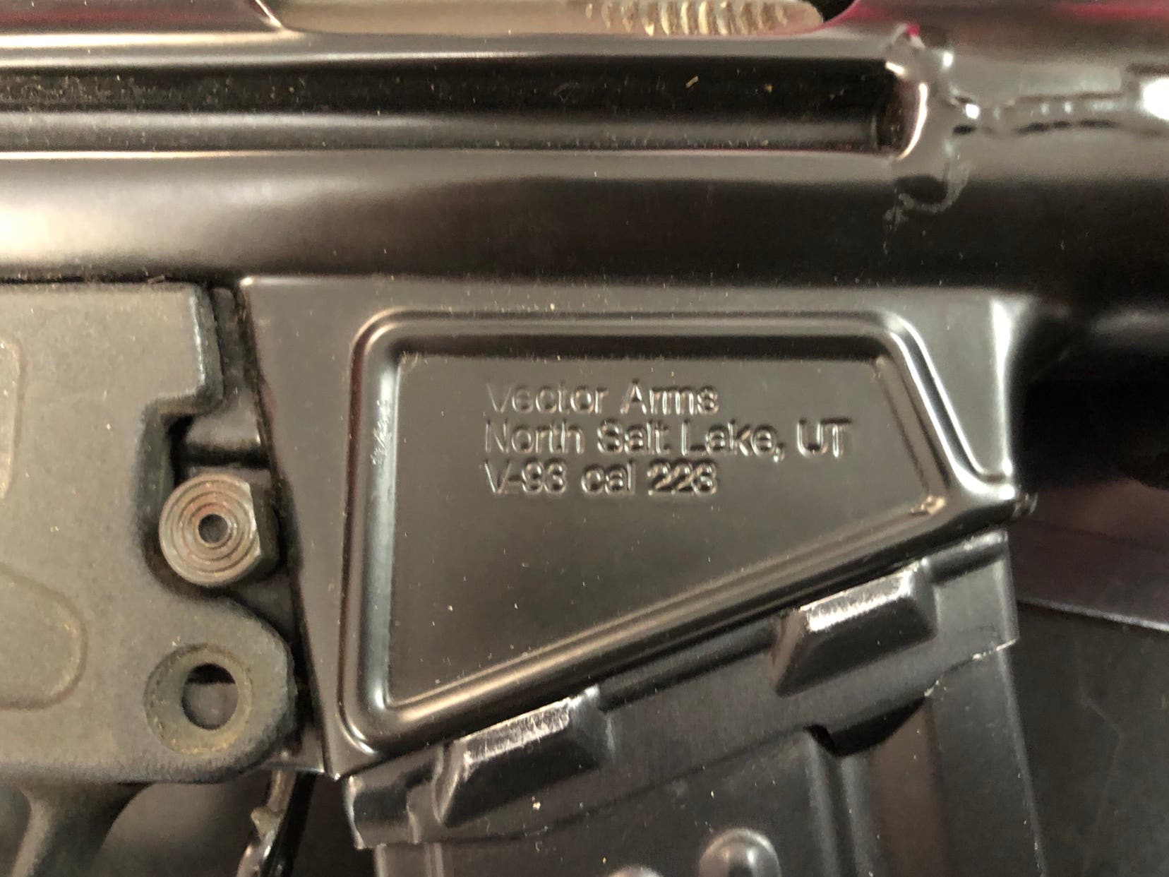

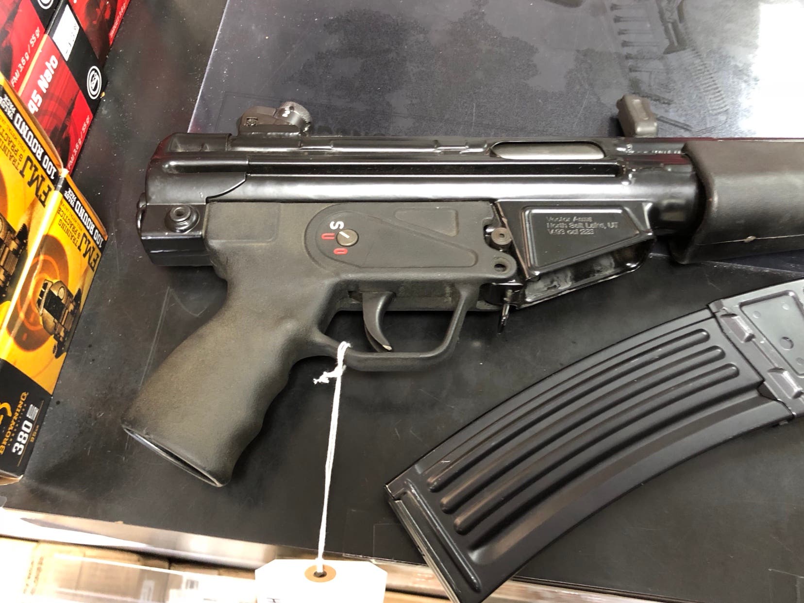

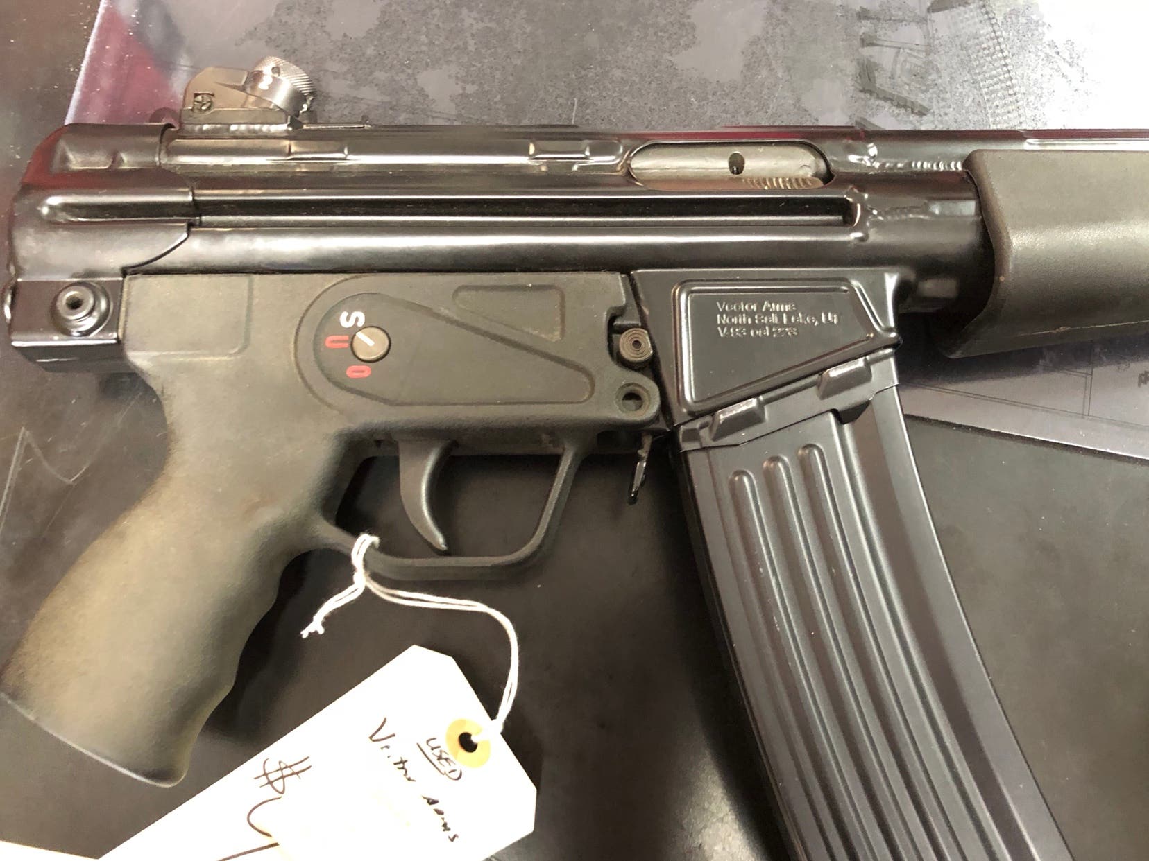

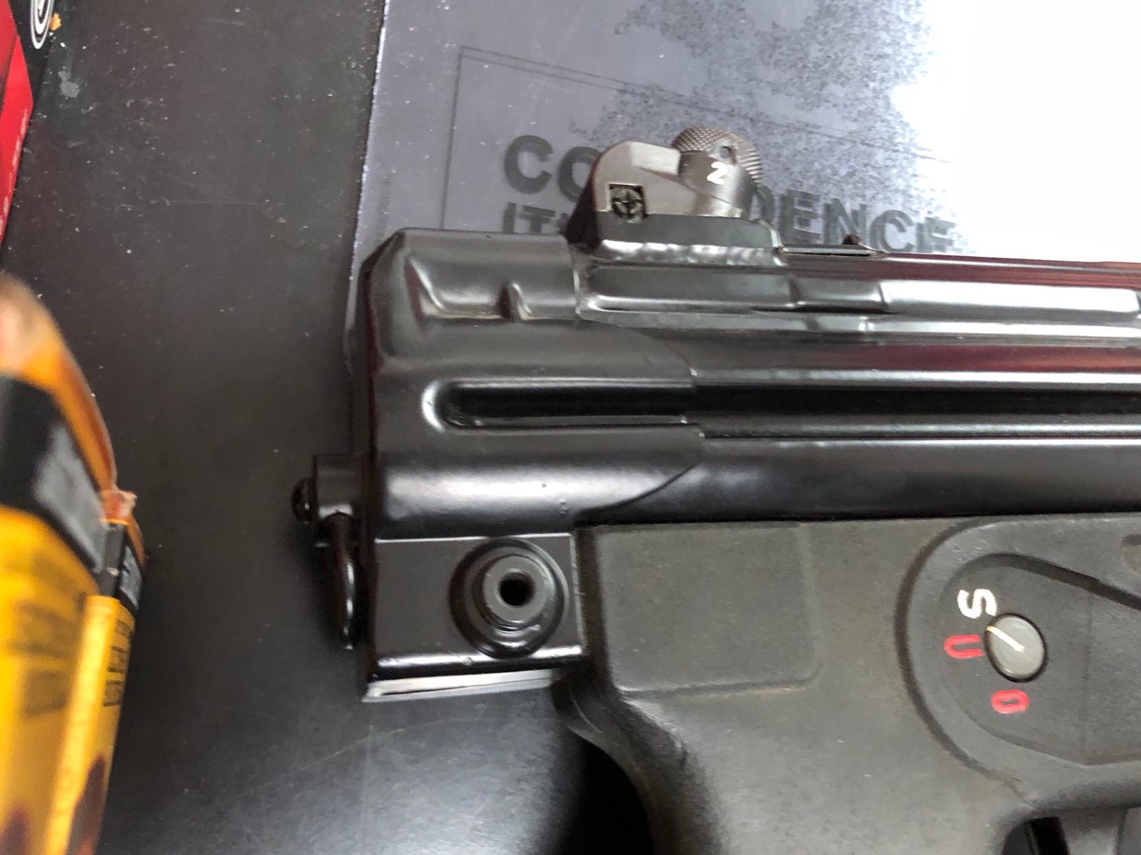

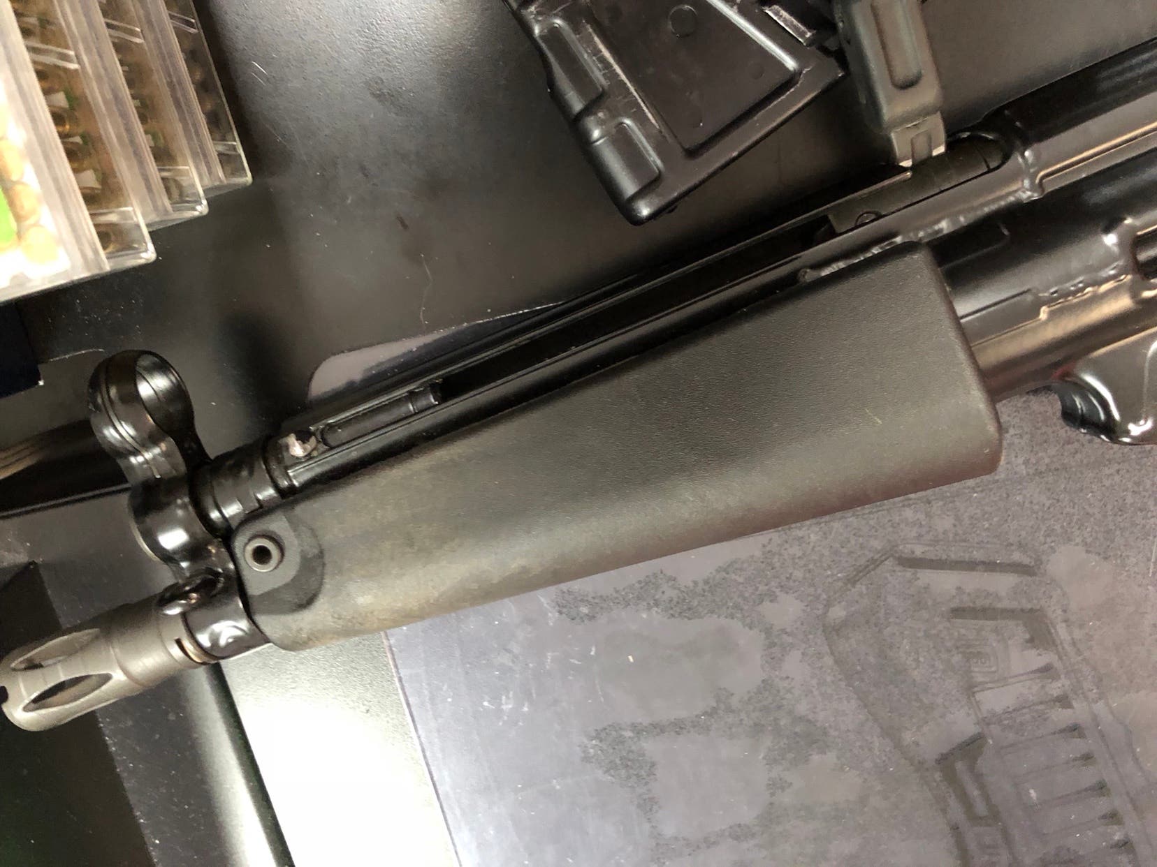

Was wondering what you all might be able to tell me about this Pistol at my LGS. After googling around it looks like V93 guns are rifles and V53 guns are pistols.
Maybe this is a really early example?

If the ffl did not get the piece directly from Vector, I doubt they will have any better idea than you. Now, if they are a long time dealer in Vectors, they may know some history. Like maybe Vector called the pistol "V93" in the beginning and then changed to V53 to avoid confusion?? I do not have much Vector history so I am just speculating.

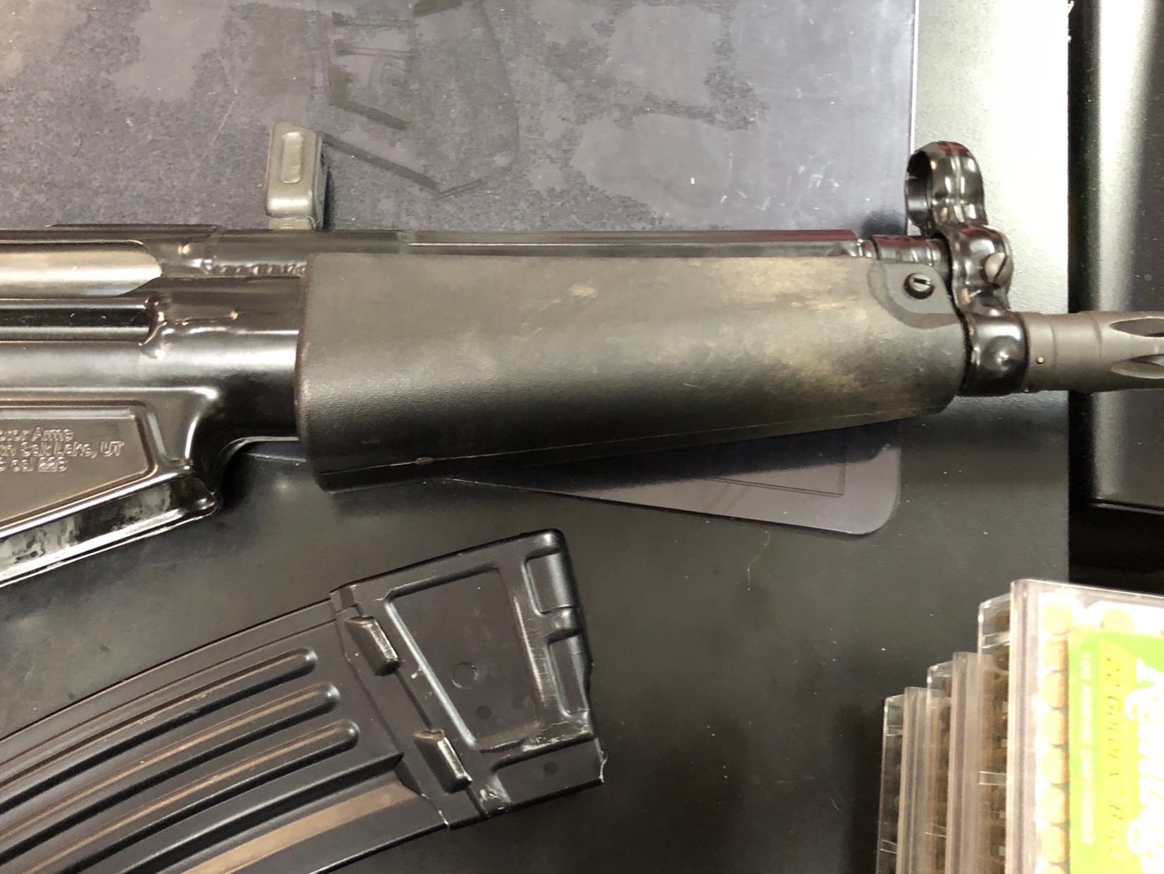

On the canted cocking tubes and inability to get on target at 100 yards. I have seen this now in one Vector, one Century and one PTR. Seems these guys start building these things, without all the appropriate jigs or QC and pass them off. They may function, but can you get the irons on target? Hence my first Vector V53 having an ACOG on it. I know now, before buying one of these clones, remove the hand guard and look down the cocking tube, and along the top of the receiver. Flip it upside down and do the same for the barrel and receiver. If it looks to be "bent", then better to pass on that gun.

Good job! Congrats! And yes, cocking tube and barrel look pretty good.
No, tight mag well should not be normal. They aren't on HK's. The easiest and immediate way to predict a tight mag well is to look inside the mag well itself. I have several C93 rifles where there are no rub marks at all and the mags rock in effortlessly and come right out without any drag or hesitation.
Now, just need to find out if anyone has developed a tool or fix for these daang tight mag wells?
One final "parlor trick" for the cocking tube condition is to remove the end cap on the triple tree and see just how concentric your cocking tube is within that triple tree. I have a photo of this from a POF MP5 I purchased. It is perfect! But don't get too upset if yours is not dead center. HK worked it all out but the clone manufacturers still deal with things like warpage when they are welding up the cocking tube, so the barrel may be straight and true, but the coking tube can take a slight bend due to welding and heat warpage. As long as the triple tree was set properly, your sights should work great with all the windage you need to get your strikes on target at distance.
