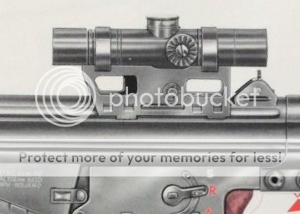

Here’s what I have. Granted it’s from the Full Circle book (credit).
I do have some other photos of a production model mount with the DIAPI-D scope attached but waiting on permission to post them.
The fist one pictured in the book is listed as a prototype. The production model (second pic) has a solid cast throw lever unlike the one that appears to be stamped sheet metal.

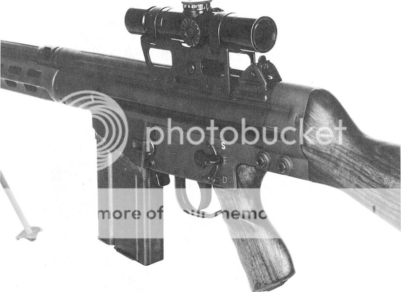

I just found out something that blew my mind. This mount possibly with ground off locking tabs? Seems to have been offered as an option for the earliest wood furniture Stoner 63 rifles. This mount must have been commercially available in the states.The owner of those mounts and DIAPI scopes has asked the same question. We have yet to come up with a plausible answer why…
Very interesting, thanks for sharing your findings.I just found out something that blew my mind. This mount possibly with ground off locking tabs? Seems to have been offered as an option for the earliest wood furniture Stoner 63 rifles. This mount must have been commercially available in the states.
View attachment 438995 View attachment 438996
This mount could not have been earlier than 1961 or later than 1963 since it appears in the early Stoner 63 marketing material. It was likely around already in 1962 when the first batch of G3’s was imported.Interesting. Any indications as to how the Diapi maintains its position within the sleeve?

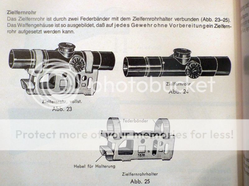

I thought the images you posted looked familiar to the ‘61, I had to pull it out to have a look.Thanks for the 1961 manual. It looks like it has the same layout at the 1966 manual just the images were changed.
I am quite sure this mount has a 27mm saddle for the 1959 Hensoldt scope. I did not see any information that the 1959 Hensoldt scope ever made it past the prototype stage. 27mm is not that common post-war. What likely happened was they had mounts for the 27mm 1959 Hensoldt scope. At some point before the Stoner 63 image, the adapter tube was added to adapt to the 22.225mm (7/8”) DIAPI-D scope. It could have been after-market or by HK.Here are some more examples of the Diapi: https://shootingglass.com/diapi-d/main.htm

The more I look the more things I notice I've missed. Like the Diapi having shorter saddles and still having lopsided anchors to accommodate the increased size from the sleeve. Which in turn made me realize that the left side anchors for this mount are slotted/hooked in rather than screwed in, which is unique amongst all the strap mounts that I am aware of. Interestingly, this also makes the Gruppe.9 statement in the '66 manual correct for both the strap and screw mounts. Only two screws either way! Although the '61 clearly indicates this is not how they would describe the strapped system.
