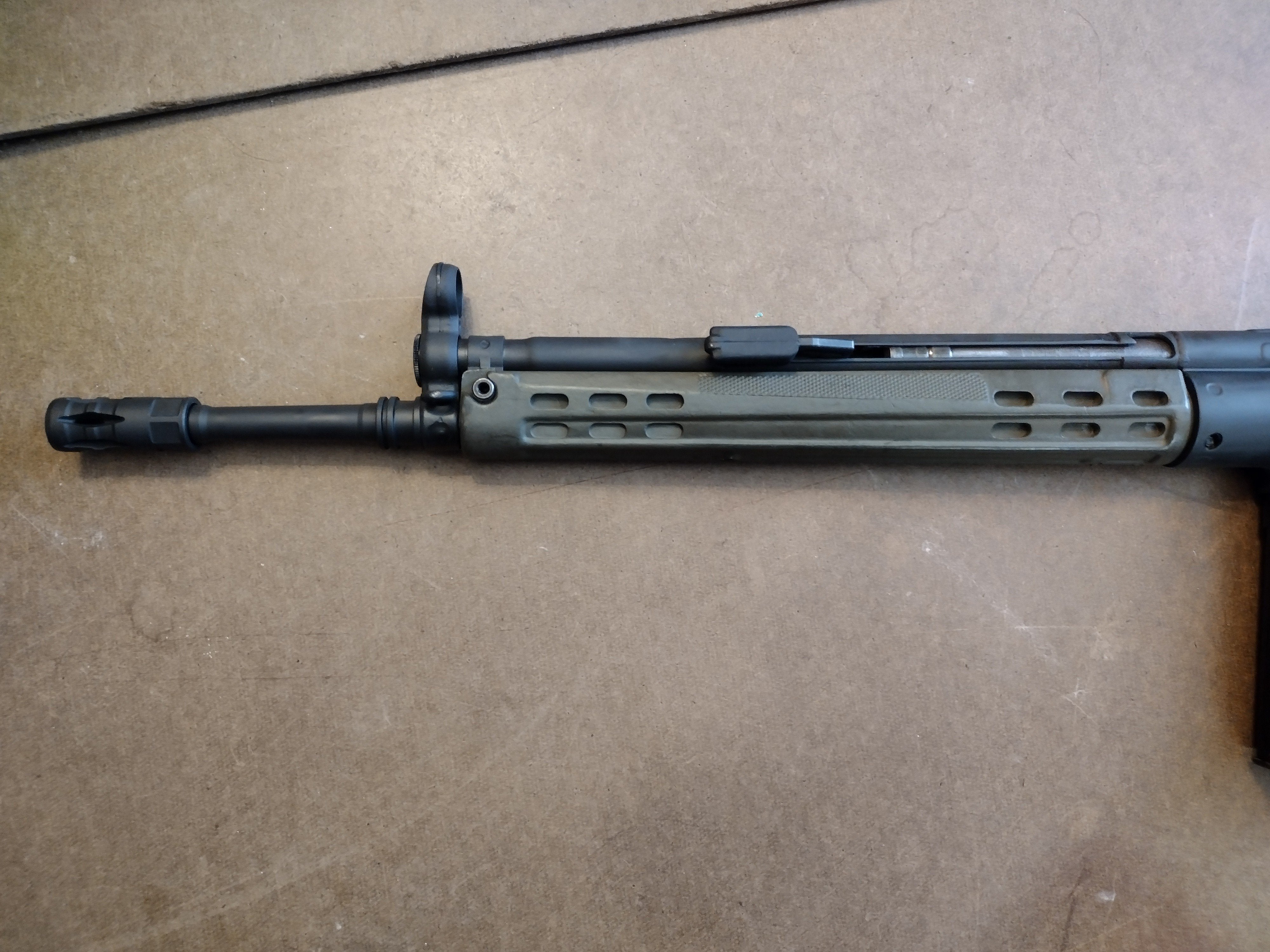

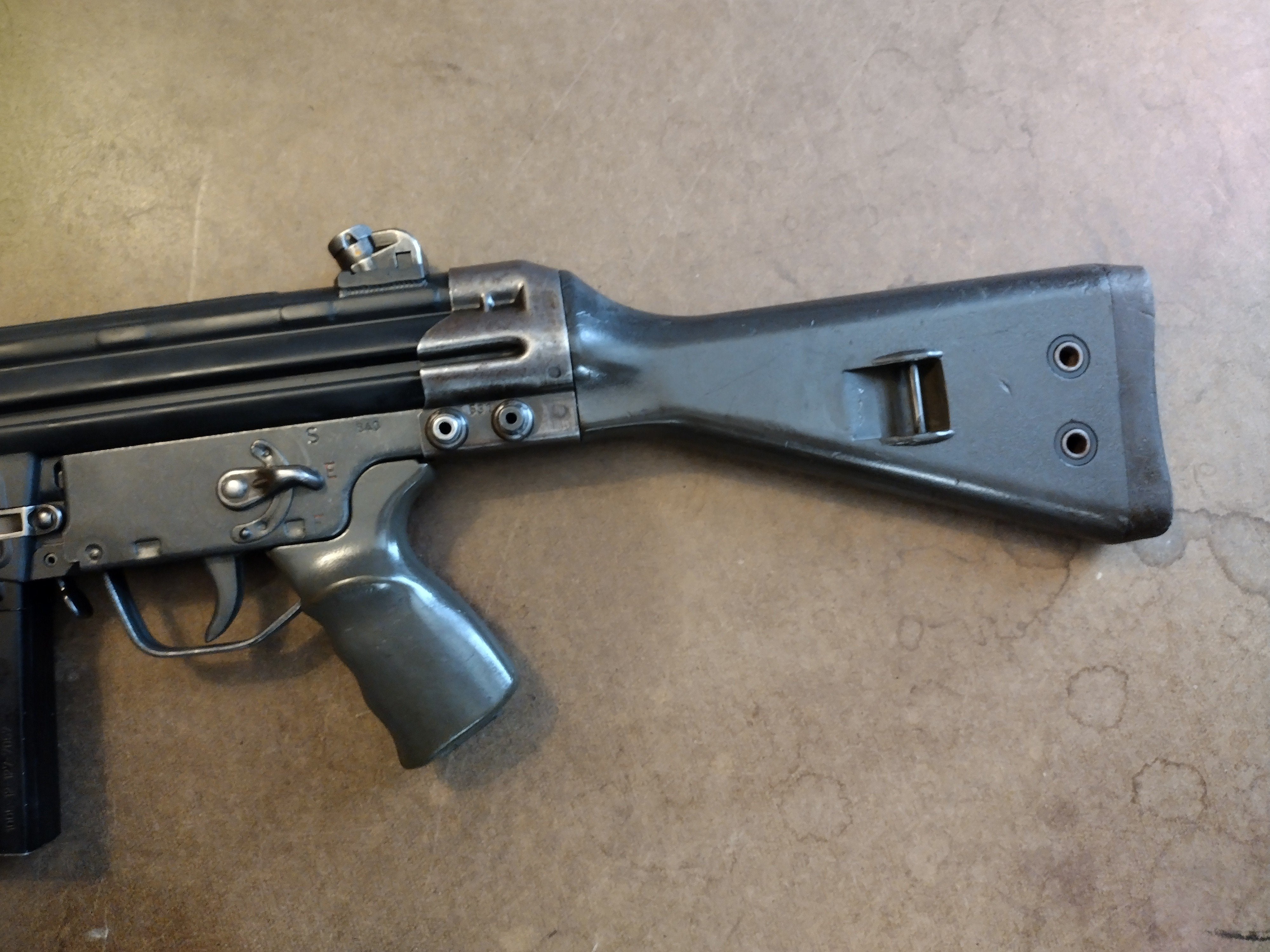

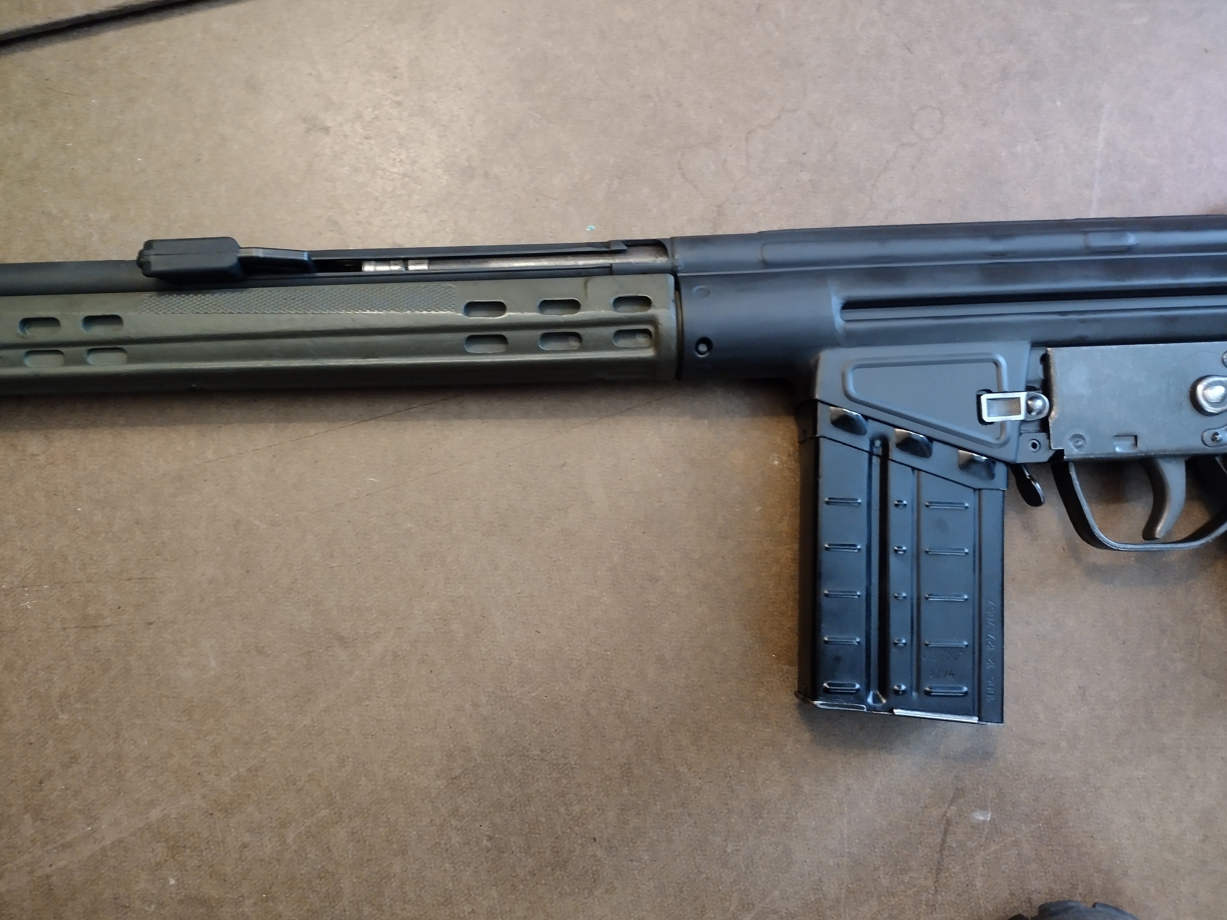

Just picked up my CA-3 today View attachment 432662
Initial Impressions are rifle is built well, Fit and finish is also really good for the parts that were refinished. Welds all look good and clean. Bolt and carrier falls freely in the receiver, stock and pins are all tight with no wobble at the rear. Bolt gap measured at .019 Will update after a range day. Major parts are 1969 FMP marked and the bolt head is HK marked and 1966 marked.
Link to whole set of pictures
I am pretty sure my bolt is a 1966 manufacture also.
